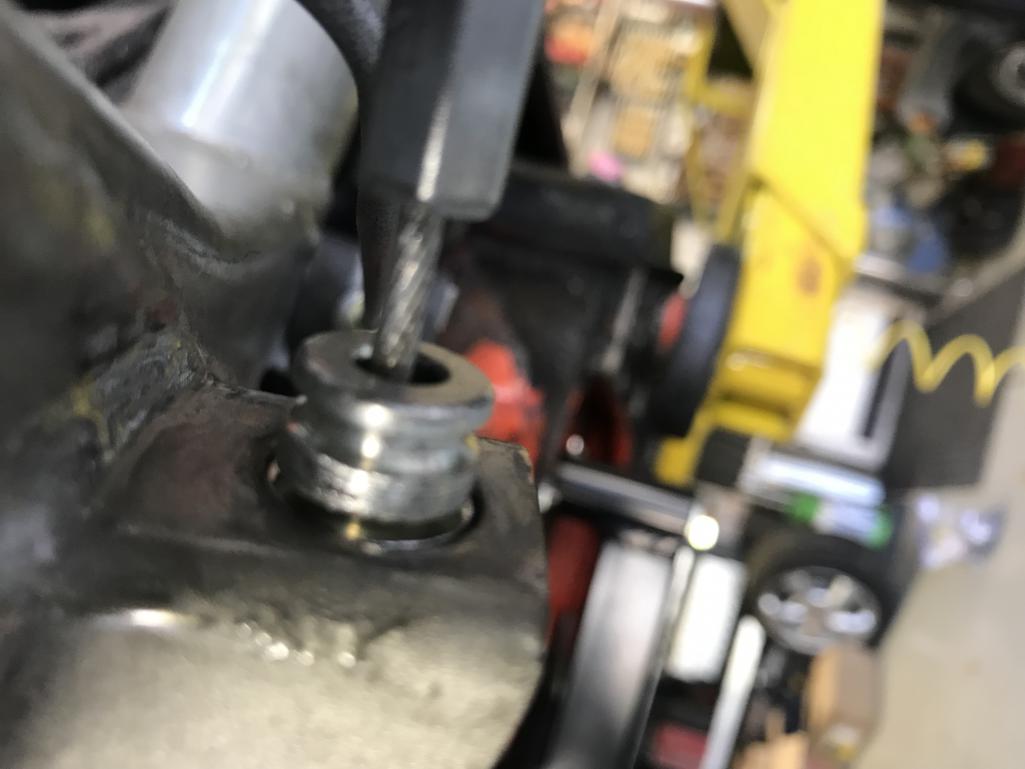

2nd question. The new E brake cable head came with a retaining clip I hadn't seen before. I have several of the standard style clips but they won't slide on because there isn't enough of the groove protruding thru the bracket. It's as if the bracket is 1/32" too thick as shown in this pic.

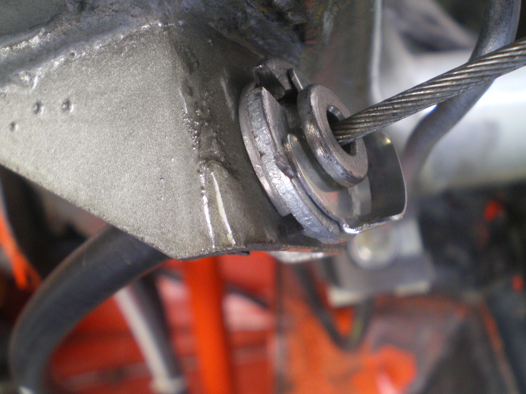

This is a pic of the small clip installed as I received it but with 2 washers between it and the bracket to take up the slack. Without the spacer it just wobbles.
