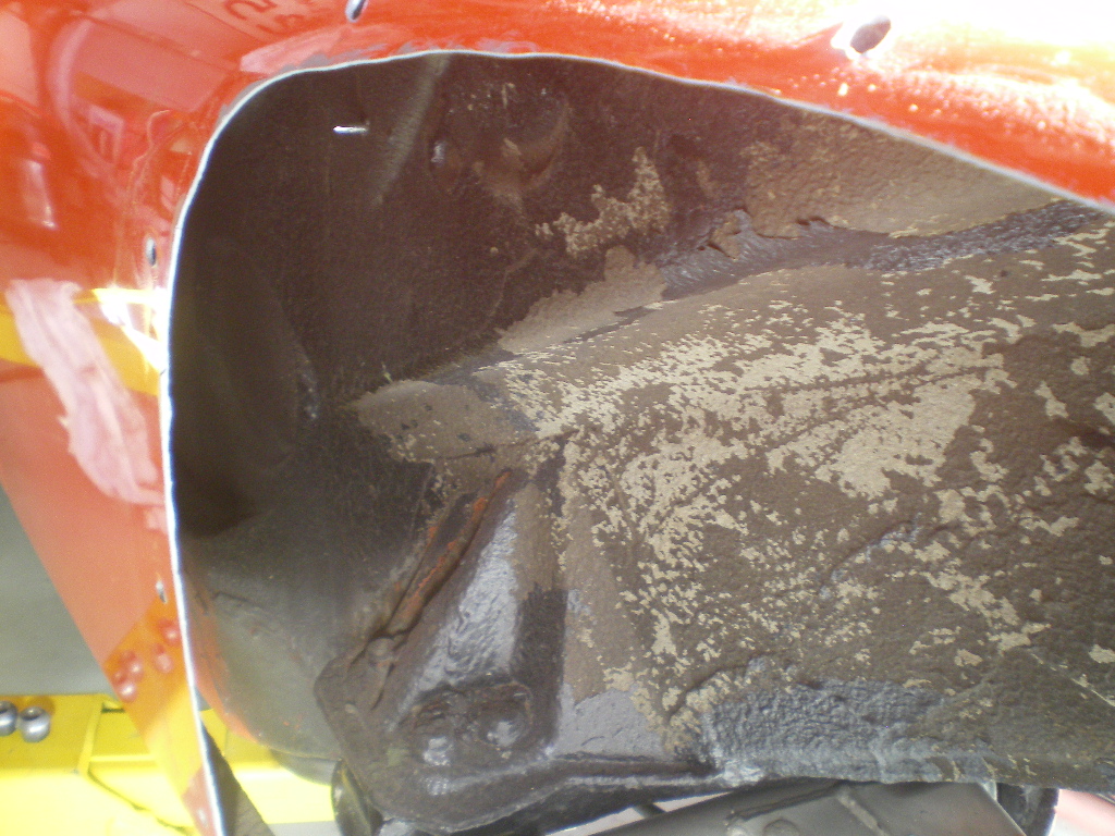

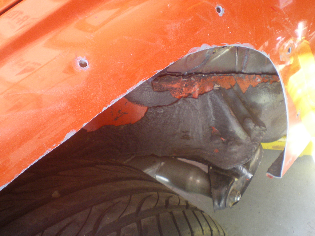

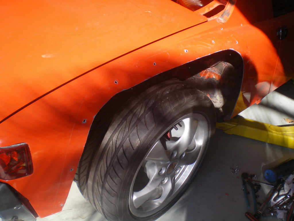

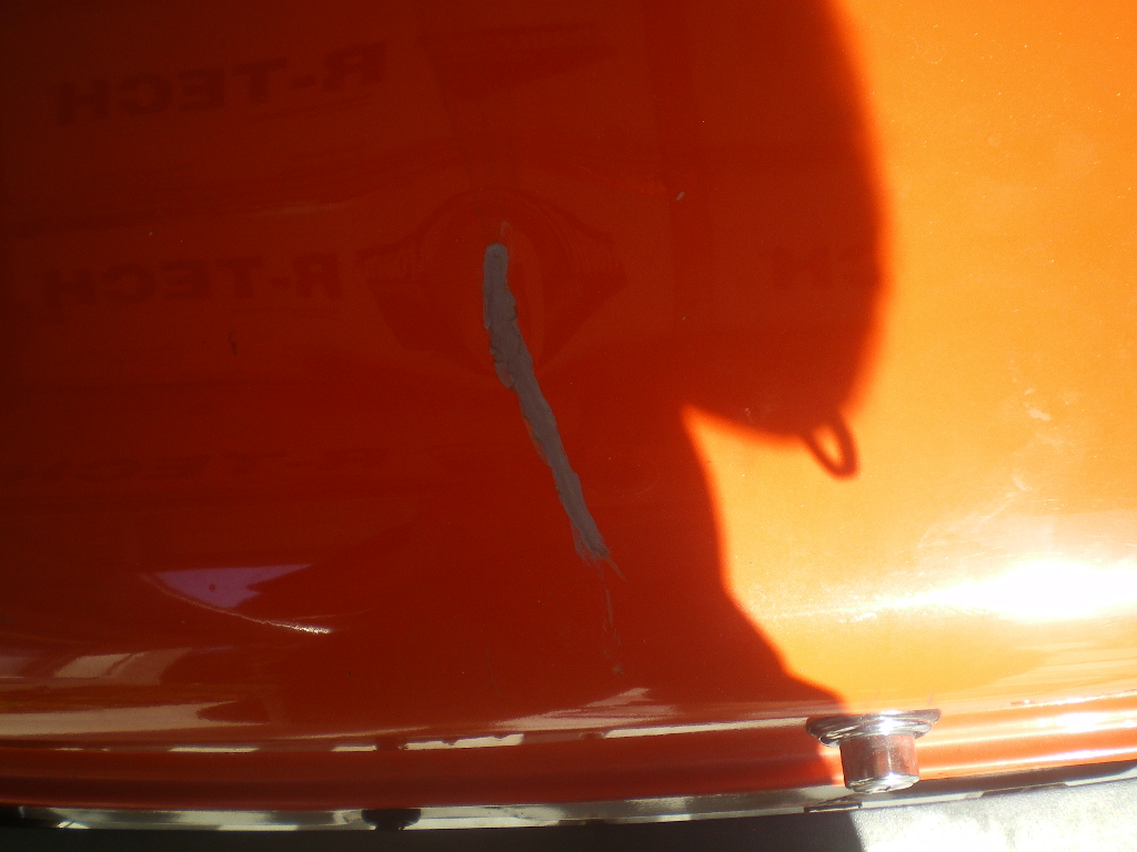

Must be 108 if both you guys agree. I couldn't access the R side as well so I pulled the flare I found the holes for the flare were drilled after it was painted so I sanded/cleaned and primed the bare metal spots where it was drilled out and on the cut line as well. While I was at it I did the same on the left side and for a gash on the rear trunk lid. That spot will be covered by a Ducktail spoiler so it will probably just get some bondo filler later.
