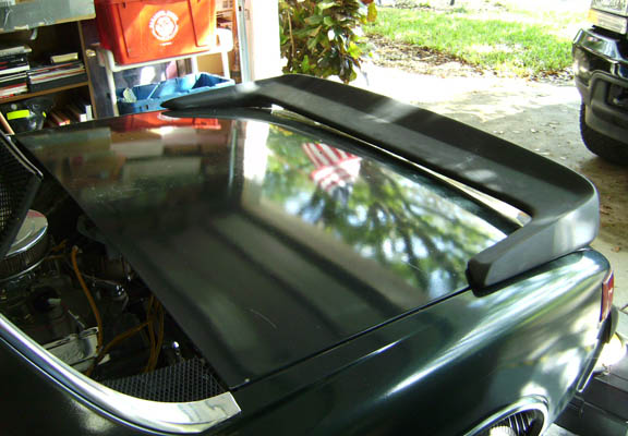

76-914
post Oct 15 2017, 09:42 AM
Posts: 13,792
Joined: 23-January 09
From: Temecula, CA
Member No.: 9,964
QUOTE(burton73 @ Oct 14 2017, 08:03 PM) *
That spot will be covered by a Ducktail spoiler so it will probably just get some bondo filler later.
Do you have the Ducktail spoiler? I have a nice small wing that was on a V8 car I had.
Bob B
I do indeed, thanks. It came with the car but had not been installed. I haven't even unwrapped it yet. (IMG:style_emoticons/default/beerchug.gif)
