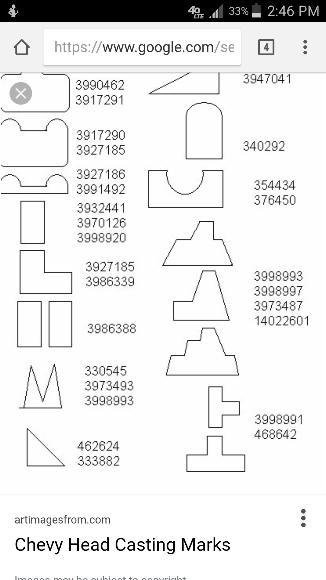

I found this on the head casting, looks like maybe a crate 350 head.
3998993
Might be the same head I ran on my v8. Lemme look. If so, I made 240hp and 290 tq to the wheels on a less than ideal setup without messing with the head. It was a torquey sob.

bulitt   Andrew thats the info I have Heads- 3998993 rebuil...   Oct 15 2017, 07:46 PM
