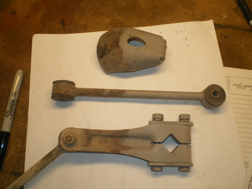

If you didn't see elsewhere this is a 1970 914 w/ a 327 and 901 transmission. I purchased the car from "Bullit" and here is some info I gotten thus far. The wiring harness is out of a '73; the front end is off a 911 but I forget which year w/ "M" calipers; Trailing arms have some of Foley's reinforcement kit; Engman inner stiffener kit was installed; Griffen radiator;window regulators from a '73; stock 914 1/2 shafts and a lot more which I'll note later.
I'm presently working on the rear brakes and trailing arms and have 2 questions. What is the torque valve for the nut that my torque wrench is attached to; 108 ft lb or 50 ft lb?
The manual says 50 for "Control arm bearing/body" and 108 ft lbs for the "Control arm bearing/control arm". Not sure which is which! (IMG:style_emoticons/default/confused24.gif)
Attached ImageAttached Image

Chris914n6   108. 50 is for the 3 bolts on the "adjustment...   Oct 14 2017, 02:53 PM
76-914   108. 50 is for the 3 bolts on the "adjustmen...   Oct 14 2017, 03:15 PM
76-914   2nd question. The new E brake cable head came with...   Oct 14 2017, 03:13 PM
zig-n-zag   I say 108 ftlbs for the nut, and the three bolts w...   Oct 14 2017, 04:10 PM
76-914   Must be 108 if both you guys agree. I couldn't...   Oct 14 2017, 05:30 PM
