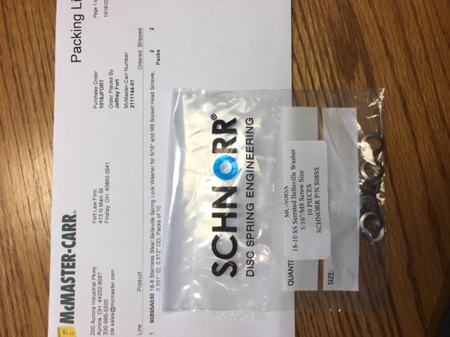

I had trouble getting the Schnorr CV joint bolt washers from Pelican who referred me to McMaster-Carr. The information is in the picture.Attached Image
