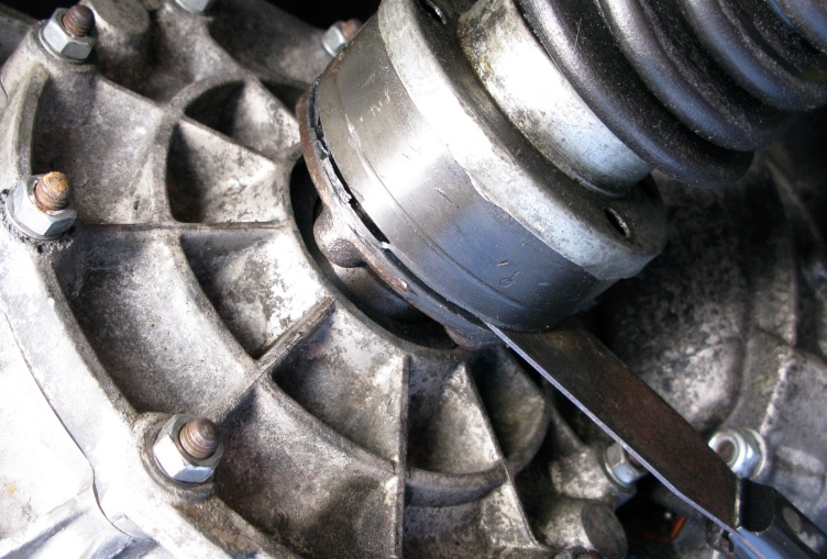

Big adventure for me. Have never done this before by myself. Taking the engine out of my 70 914-6.
I got everything, I think, disconnected and/or removed today -- except the half shafts. My memory is failing me. 5-10 years ago, I bought and installed bolts that were drilled for safety wires, which I did. Now I can't remember if they were 6mm Allen, which seems to fit if I can get it squarely in, or was there a spline fitting? I found a single spline thing with my Allen sockets that is just about the same size, perhaps 8. Something tells me it might have been purchased for those bolts. I can get the 6mm in there, but I am not sure that is it and I don't want to round the inside of the fastener. The spline thing may be too big or I may not have it square. Scared to pound it in.
The bolts are tight. Aren't they always? They got a dose of pbBlaster for the night. I'll finish this tomorrow, I hope.
Are the OEM bolts 6mm? Did anyone here install the drilled bolts and can you tell me, Allen or spline? What size? Any tricks getting them loose? A universal with an extension? (I just have headers) Use an impact wrench? I must have done this part of the job before, but the memory thing . . .
I seem to recall torque wrenching them, too. What should they be torqued to?

When I removed my CVs I found the PO had used some type of sealant like RTV instead of gaskets and they hadn't leaked.
I cleaned eveything and reassembled with gaskets; we'll see who was smarter.
re: Schnoor washers-
Which way is the correct orientation- pointing towards the bolt head or away?
