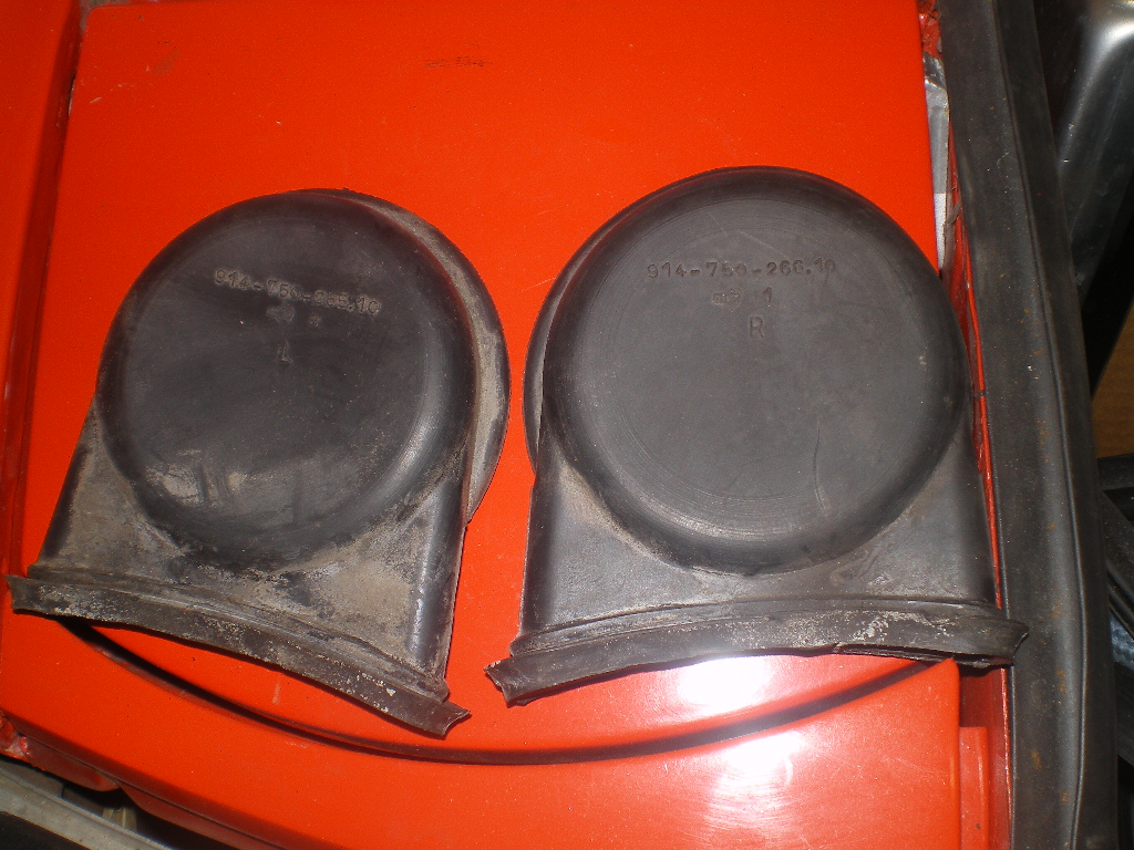

I tried to install these today but their appx 1" longer than the opening. Did the 70 model have a different size guard or did they not have them, period? TIA, Kent

QUOTE(76-914 @ Oct 18 2017, 07:17 PM) *
Early cars had a brush. 914rubber had talked about making them.
