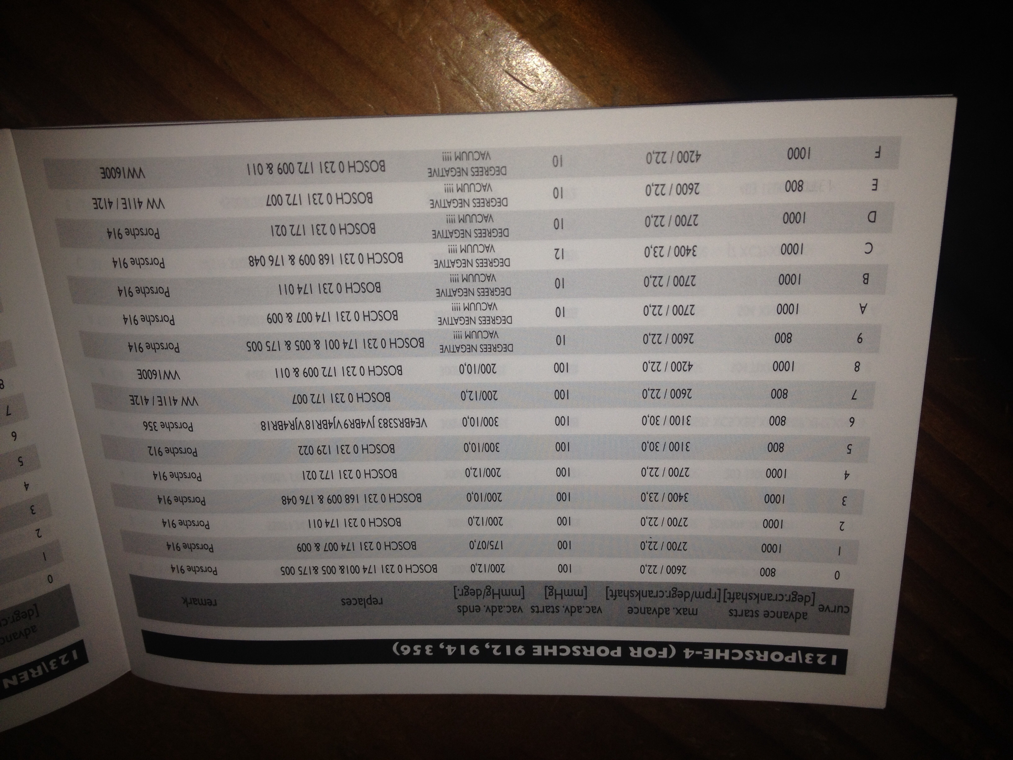

I thought if it had 'hardcoded advance curves" a vacuum can for advance/retard would be redundant and unnecessary. My stock '74 2.0L does not have a vacuum advance, only retard, but the 73 2.0L has an advance.
Does this 123 dizzy for stock D-jet provide the advance/retard functions to replace the vacuum can?
mgphoto
post Oct 19 2017, 03:15 PM
"If there is a mistake it will find me"
Posts: 1,501
Joined: 1-April 09
From: Los Angeles, CA
Member No.: 10,225
QUOTE(Jeff Bowlsby @ Oct 19 2017, 01:01 PM) *
Single vacuum port, if I have it correct the '74 D-Jet retard port only should connect to the dizzy vacuum port and switch set to B.
'73 advance port connects to dizzy and switch set to #1.
But I could be wrong.

QUOTE(mgphoto @ Oct 19 2017, 02:15 PM) *
Yes you could be.

[/quote]
[/quote]
Yes you could be.
[/quote]
From the install manual.

[quote name='mgphoto' date='Oct 19 2017, 03:39 PM' post='2539516']
[/quote]
[/quote]
Yes you could be.
[/quote]
[/quote]
So for the benifit of the other readers what year is your D-jet system and what vacum port did you tap for the 123 Dizzy.
Can you post picture of the distributor installed and leave the hood on another thread please?
Thanks.
