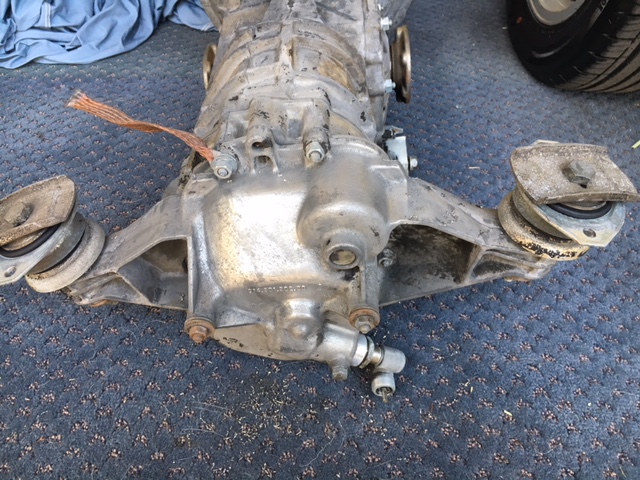

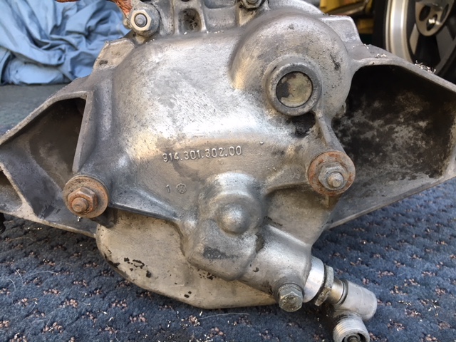

On that note the transmission case will not be blasted, but it was suggested that it be cleaned up with a wire brush and steel wool. Is that the correct way to go and similar to the shroud does it require a clear painted finish or just leave it alone. Here is a pic of a small section that I went over with steel wool after degreasing.

Spoke to a high end 911 restorer earlier today and confirmed that brass wool is the way to go on the transmission case. Also learned that media blasting may be too harsh for the fan shroud so I now have a line on someone that can do tumble blasting that is more gentle.
Here's the kicker, the recommendation is not to coat the magnesium with any paint or clear finish, but to liberally spray it with WD-40 for a natural finish and leave it alone.
As good as all of the painted photos look, I will go with the unfinished look.

I saw no harm and couldn't think of any on powder coating the fan shroud. I brass wheeled the trans case and used Gibbs as described keep the mag from corroding. The trans gets hot so I didn't want any insulation to inhibit radiation of heat away from it.
It's probably not much but with air cooled motors every little bit helps.
