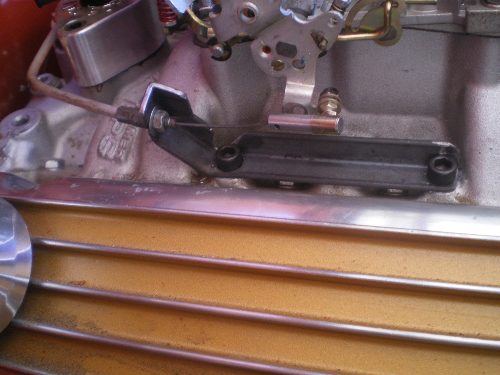

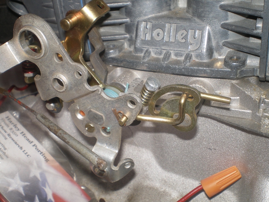

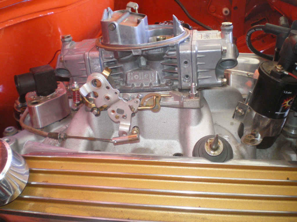

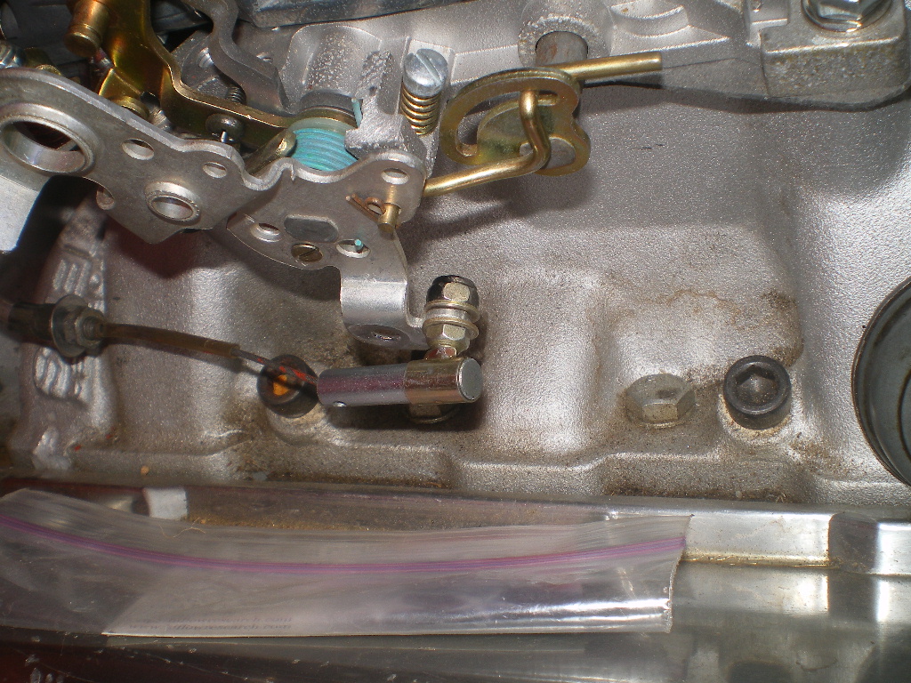

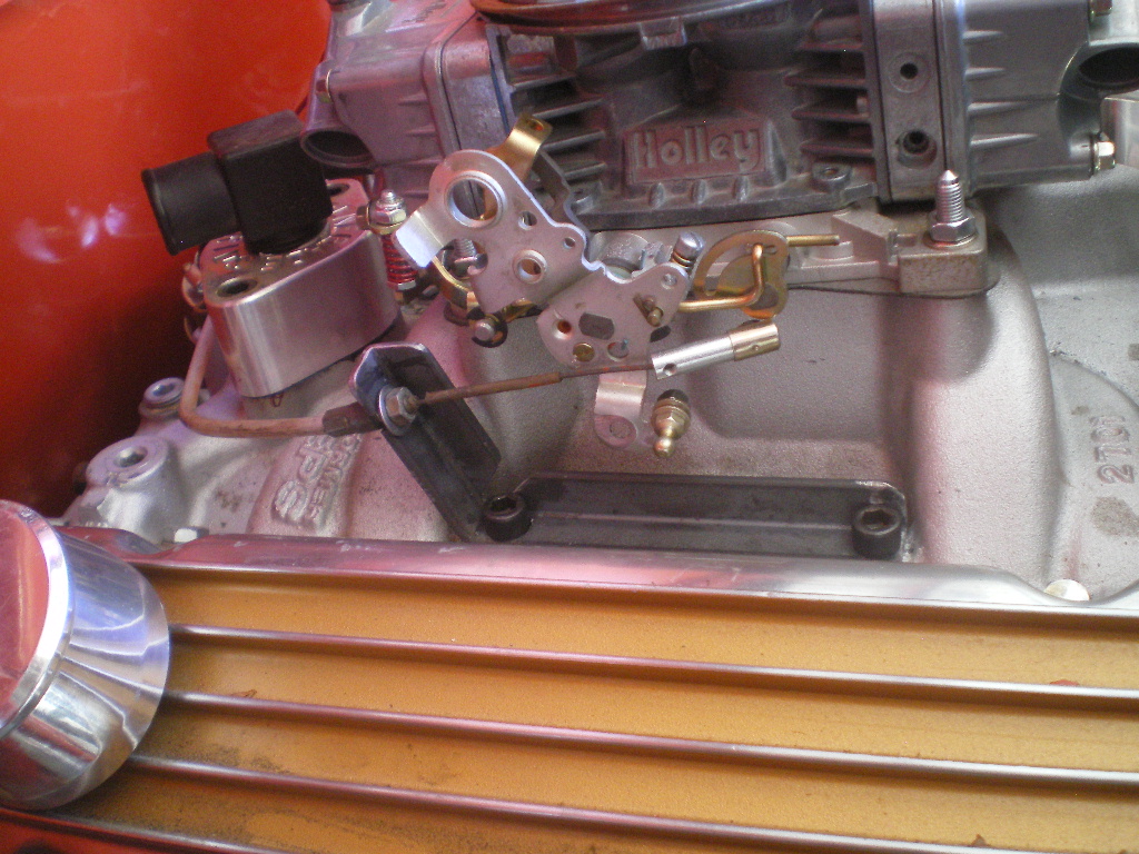

I'm working on "how to" use the existing 914 throttle cable. I fished the cable reasonably close to the carb to see if it would reach. There wasn't any place to connect the cable on the carb linkage so I drilled out that small tab that is bent at a 45 degree angle then straightened that tab out to accept the barrel adapter that I had laying around.
After fitting the barrel to the linkage I cut the end off the cable and fit it inside the barrel.
Next I heated that stiff plastic sheathing to bend it towards the carb.
I made this bracket to hold the cable in place. I couldn't bend this bracket to 90 degrees or the barrel would contact it before it reached maximum pull i.e. full throttle but at this angle the cable was pointing up and would bind.
I placed another bend in the bracket to level it out. seems to line up alright so next step is to remove this old cable and replace it with a new one.
