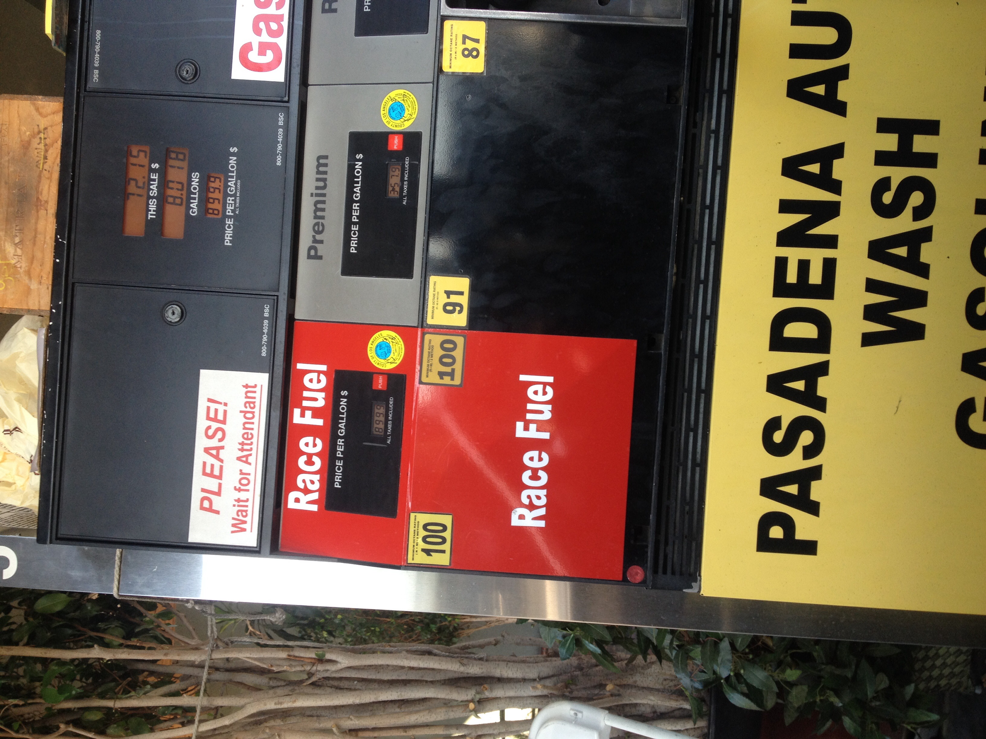

mgphoto   I took her out for an early spin on Saturday, 68*F...   Oct 30 2017, 12:15 PM

Rand   Early spark is the most common cause. Cylinder pr...   Oct 30 2017, 02:27 PM
Philip W.   i agree that your timing has to be off but also yo...   Oct 30 2017, 07:53 PM
mepstein   Our cars run on regular fuel. Unless modified, the...   Oct 30 2017, 08:20 PM
Rand   When you change a part that affects timing and you...   Oct 30 2017, 08:29 PM

mgphoto   about 3 gallon of techron 91 left in the tank, too...   Nov 7 2017, 09:58 AM
mgphoto   Running on the last 2 gallons of the Chevron, I de...   Nov 13 2017, 03:37 PM
