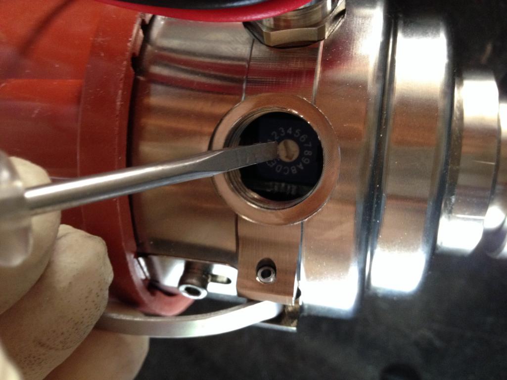

Don't know why they are 90* off in the post but correct when viewing the image alone.
Here is the 123Porsche-4-R-V-IE advance selection port.

mgphoto   Don't know why they are 90* off in the post bu...   Oct 24 2017, 12:31 PM
mgphoto   FYI type 4 needs a spacer which should come with t...   Oct 24 2017, 12:34 PM
