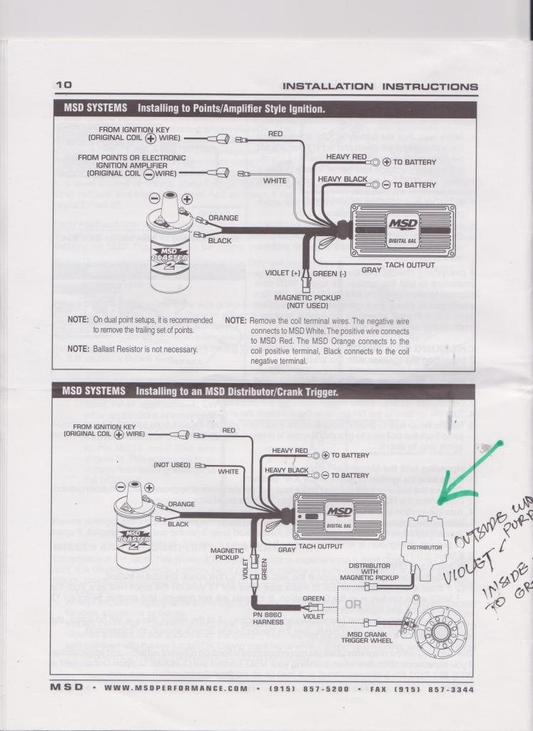

All leads from the MSD plug to the P.K. wiring harness (that has been flawless for the past several thousand mile of seamless spark) show continuity. the coil is good to go - as proven by exchanging Keiths with mine and mine with keith's... His car runs mine doesnt.
We performed several Parts Classic tests to prove that the distributor is good and not fouled in any internal way. I replaced the 85 dollar little green wire (Pelican Parts... ridiculous (IMG:style_emoticons/default/WTF.gif) ) then replaced the coil wire with another MSD unit with the "Power Tower" to allow a standard coil to mate to MSD proprietary wire ends.... another (IMG:style_emoticons/default/WTF.gif)
anyway,... One of the MSD Tech guys was a smartass smug dipsey doodle talking down at Keith and I - and the second guy from MSD Tech that both Keith and I talked to (Joe) was a complete professional in style and manner of presenting a few tests to eliminate the coil and the distributor (ahhhgen...)
So my simple question for the folks out there is.. Has anyone with the MSD Digital AL6 experienced this kind of DOA mystery? the hills and mountain roads leading to the Grand Canyon are begging for an answer.
The simple way to add a week to no driving is to pack up the box and send it to MSD for a test / and I will do that if no sage advice comes from this lengthy narrative..

A question for MSD 6AL digital box people: Is there a rogue security feature kill-wire in the harness as delivered from MSD? I seem to remember something about using or not using a wire as a kill switch to ground...... maybe the white wire (unused in the diagram)
if so, that could be grounded somehow and simply killing my spark.
