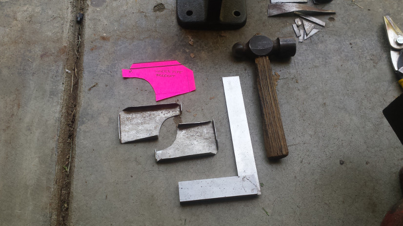

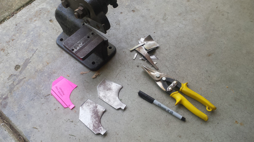

OK, so need some brackets to hold the heater pipes in place. Made a pattern and clipped them out:
And here they are folded up:

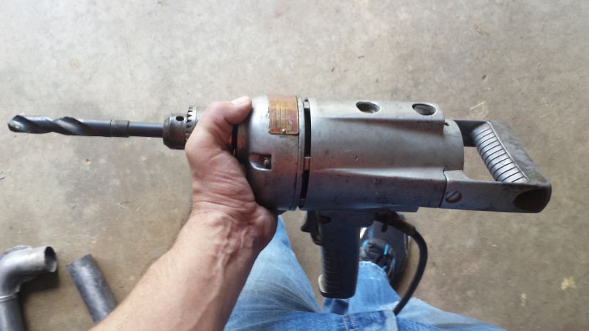

You know I got that extra-thick long welded in and then I was reading a thread about seat-belt bosses. Luckily it's not too late!! Ordered it from 914Rubber... It needs a fairly large hole in some 12g sheet to mount that thing; drill bit needs a 1/2" chuck. Can't use my hand drill, can't fit the 914 on the drill press. Called my vintage-tool-enthusiast buddy, he loaned me this wrist-breaker:
