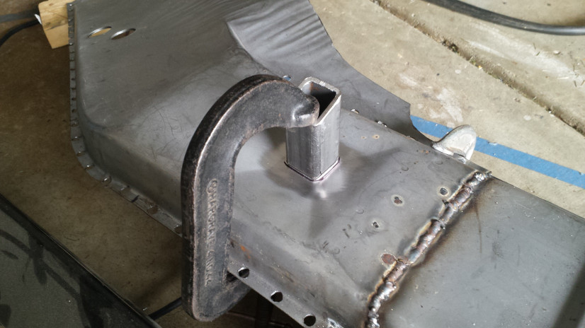

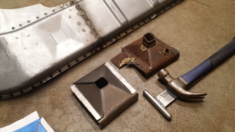

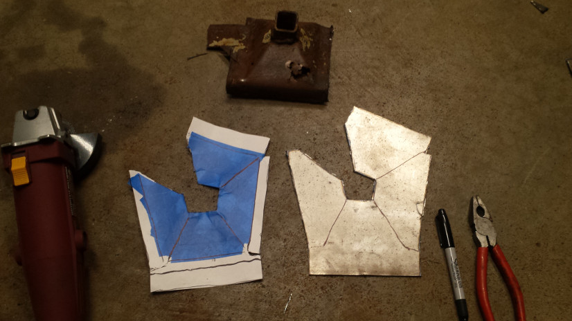

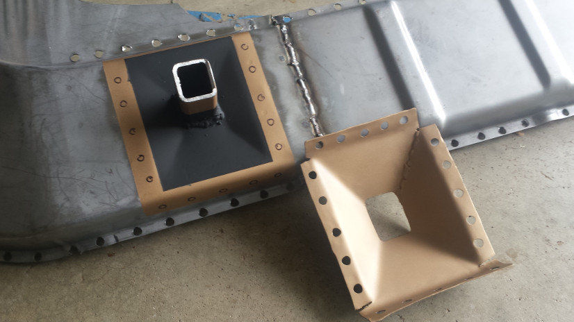

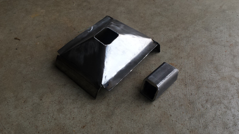

Another thread I was reading was talking about how much additional strength comes from the jack post. I was planning on leaving that off, and since my longs are well reinforced I thought it still might be OK. But in the end, I figured I'll take more strength wherever I can get it and since I still have the stock jack, might as well rebuild the jack posts.
Made a pattern from the old one, snipped out the metal:
Hammer time:
Got some square tube from the local metal supplier, kit needed some adjustment when all was said and done:
You don't see it here but I used the valance to position this guy:
Needed to make some adjustments to the hole in the middle, ultimately a tiny bit of patch metal has to go in. I'll adjust the pattern before doing the other side. Some tapping with the hammer to get the flanges to conform to the long, then drilled for the rosette welds and primed- switched to the copper based weld-through, it does seem to weld easier:
