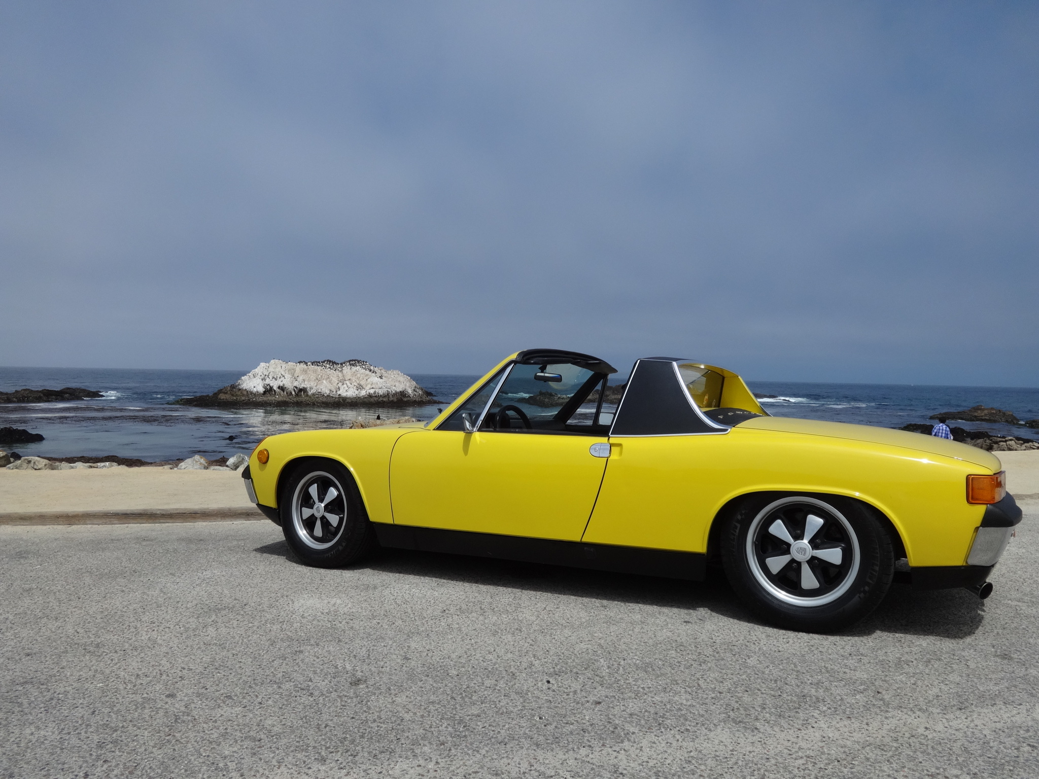

GeorgeRud
post Oct 26 2017, 08:42 PM
Posts: 3,725
Joined: 27-July 05
From: Chicagoland
Member No.: 4,482
195/65-15 Michelin Exaltos on 6x15” Fuchs look right to me.Attached Image
