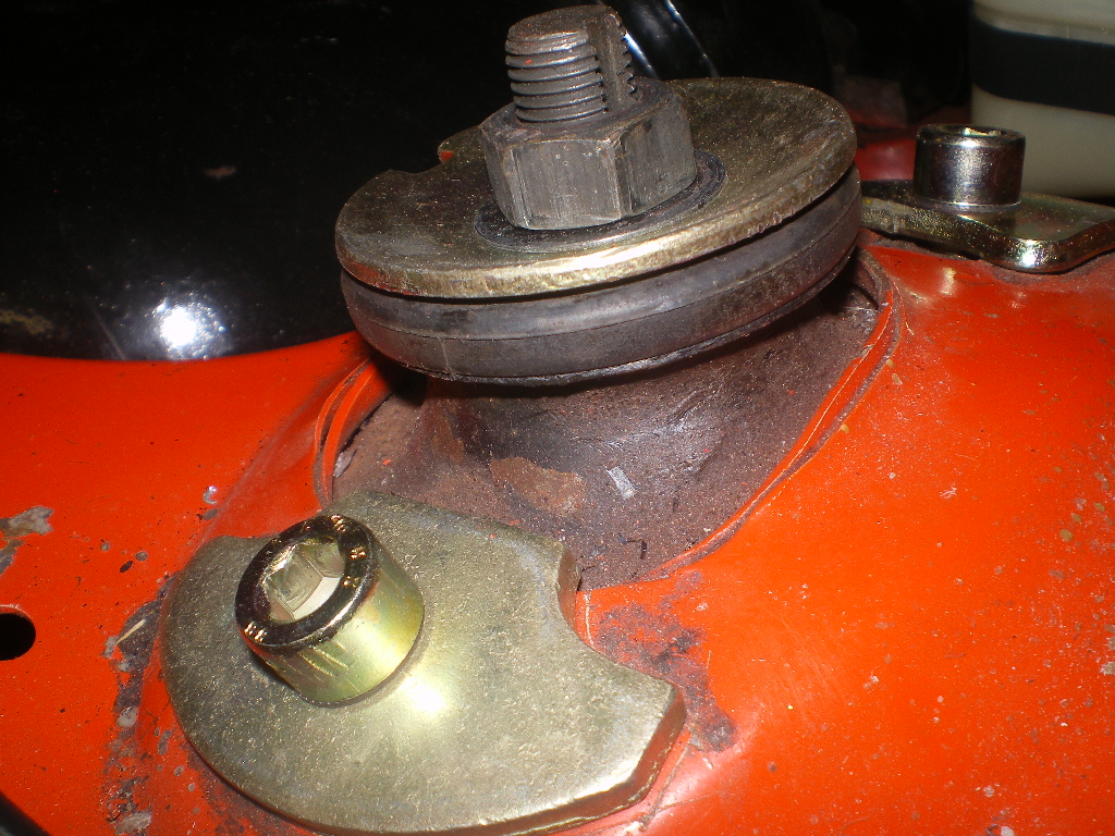

If you didn't see elsewhere this is a 1970 914 w/ a 327 and 901 transmission. I purchased the car from "Bullit" and here is some info I gotten thus far. The wiring harness is out of a '73; the front end is off a 911 but I forget which year w/ "M" calipers; Trailing arms have some of Foley's reinforcement kit; Engman inner stiffener kit was installed; Griffen radiator;window regulators from a '73; stock 914 1/2 shafts and a lot more which I'll note later.
I'm presently working on the rear brakes and trailing arms and have 2 questions. What is the torque valve for the nut that my torque wrench is attached to; 108 ft lb or 50 ft lb?
The manual says 50 for "Control arm bearing/body" and 108 ft lbs for the "Control arm bearing/control arm". Not sure which is which! (IMG:style_emoticons/default/confused24.gif)

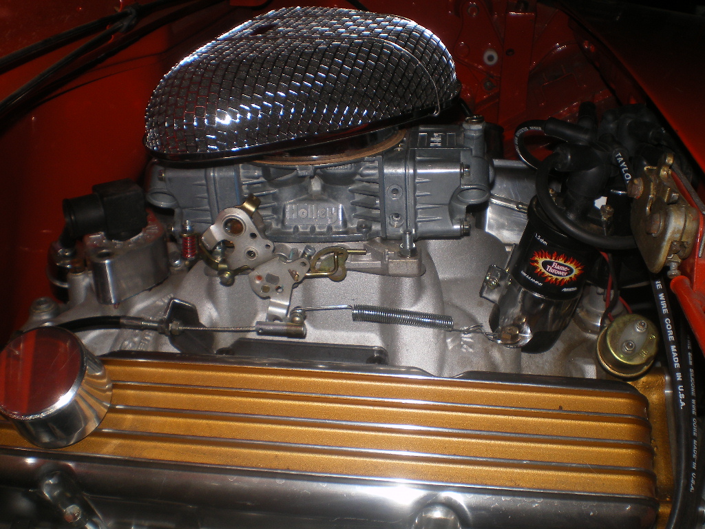

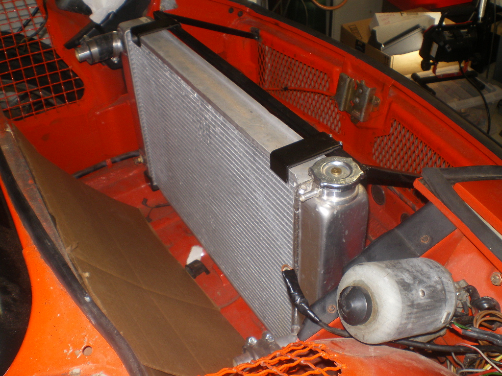

Finally got a chance to work on Red today. Finished mounting the radiator but still need to fab the plenum and mount the fans. That'll have to wait until I get up to Aircraft Spruce for some aluminum. Guess I should start plumbing it in the meantime. (IMG:style_emoticons/default/idea.gif)
Installed some of the "Bling" that came with the car

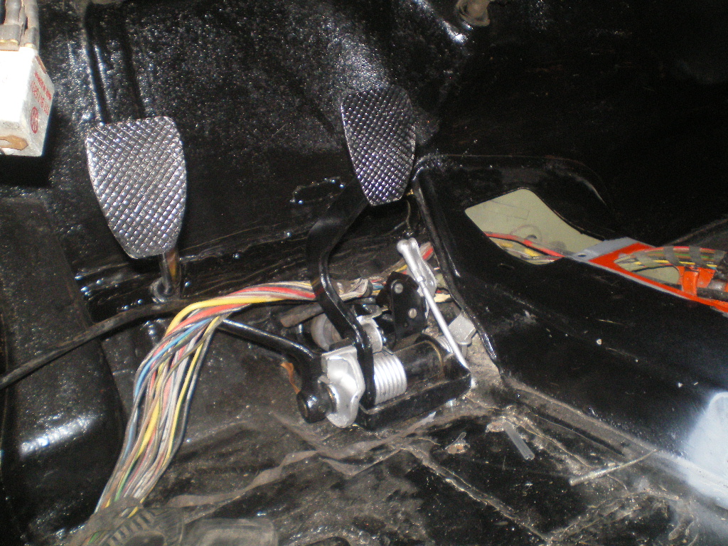

My clutch pedal now stands on it's own since I connected the clutch

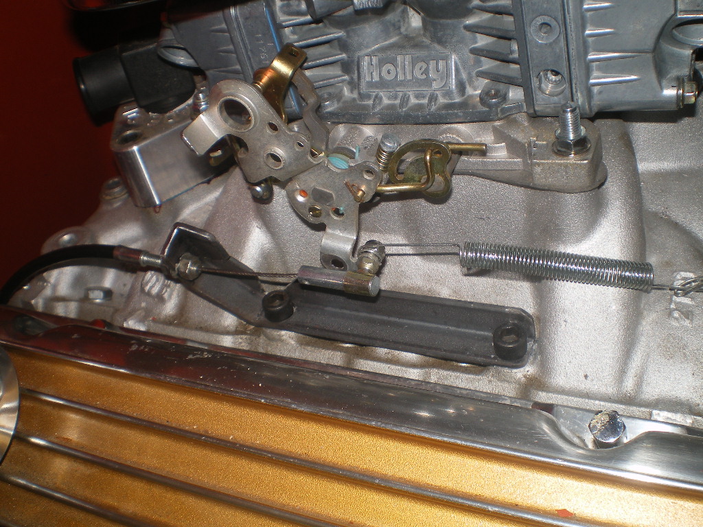

And my acellarator now functions. The old cable was toast so I put a new one in. I used one that I had ordered for Kugal when I converted it to a Suby 6 but they made it wrong so they gave it to me. Well guess what; it fit Red perfectly. (IMG:style_emoticons/default/biggrin.gif) The only thing I need to do now is attach the pedal but that would just be in the way at this stage.

Chris914n6   108. 50 is for the 3 bolts on the "adjustment...   Oct 14 2017, 02:53 PM
76-914   108. 50 is for the 3 bolts on the "adjustmen...   Oct 14 2017, 03:15 PM

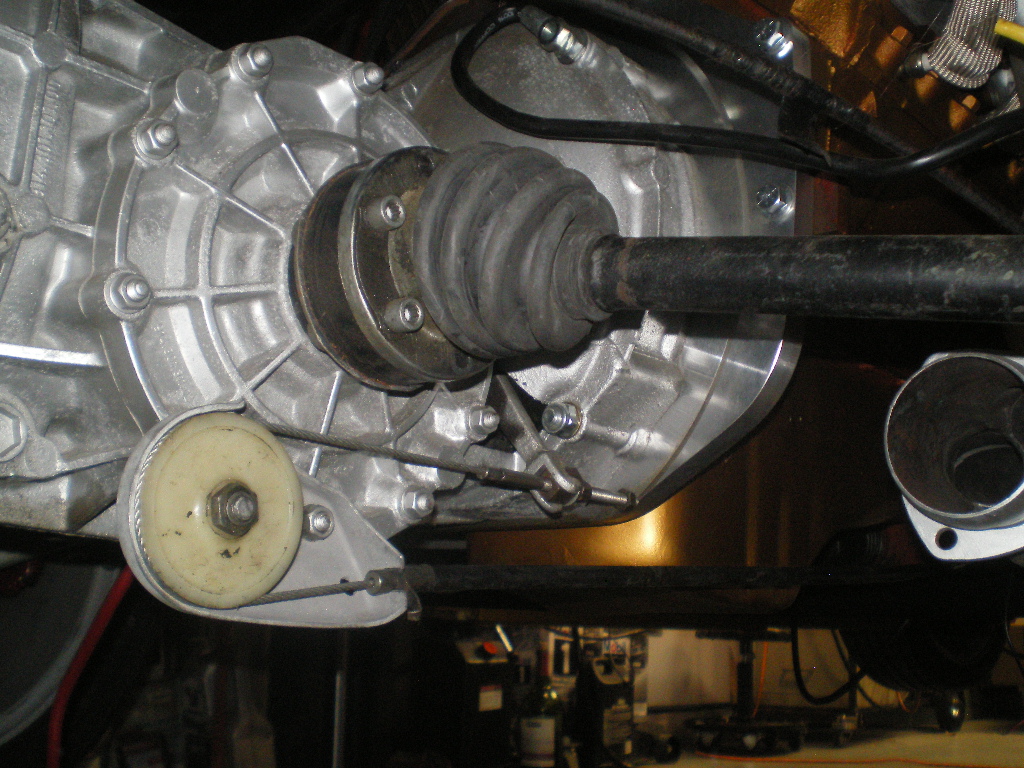

76-914   2nd question. The new E brake cable head came with...   Oct 14 2017, 03:13 PM
zig-n-zag   I say 108 ftlbs for the nut, and the three bolts w...   Oct 14 2017, 04:10 PM
76-914   Must be 108 if both you guys agree. I couldn't...   Oct 14 2017, 05:30 PM

76-914   Made the rough cut templates out of cardboard. The...   Nov 2 2017, 08:23 PM
76-914   The side will get a trim flange to fill the void o...   Nov 2 2017, 08:27 PM

rhodyguy   Kent, contact TC914-8 (tony) about the carb linkag...   Nov 3 2017, 09:11 AM
76-914   Thx Andrew and Bob. When I peel back that protecti...   Nov 3 2017, 05:33 PM

914350   I love the way you mounted the radiator. The shrou...   Dec 13 2017, 11:18 AM
76-914   I love the way you mounted the radiator. The shro...   Dec 13 2017, 06:31 PM

76-914   I forgot to add these pic's once I closed up t...   Jan 14 2018, 01:39 PM
mepstein   Very clean looking. Is that an RH setup?   Jan 14 2018, 01:49 PM
Mueller   Nice radiator setup...might want to add a bead or ...   Jan 14 2018, 02:31 PM

76-914   Very clean looking. Is that an RH setup? Don...   Jan 15 2018, 09:19 AM
