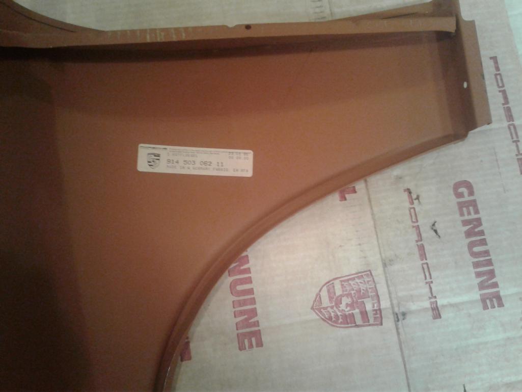

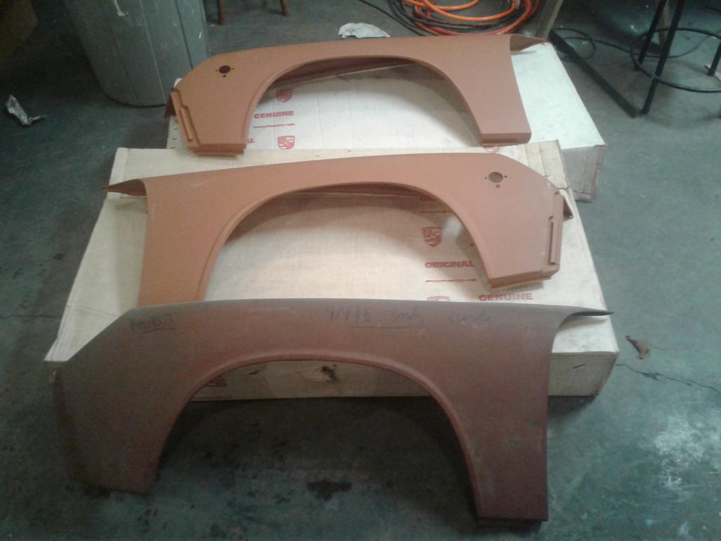

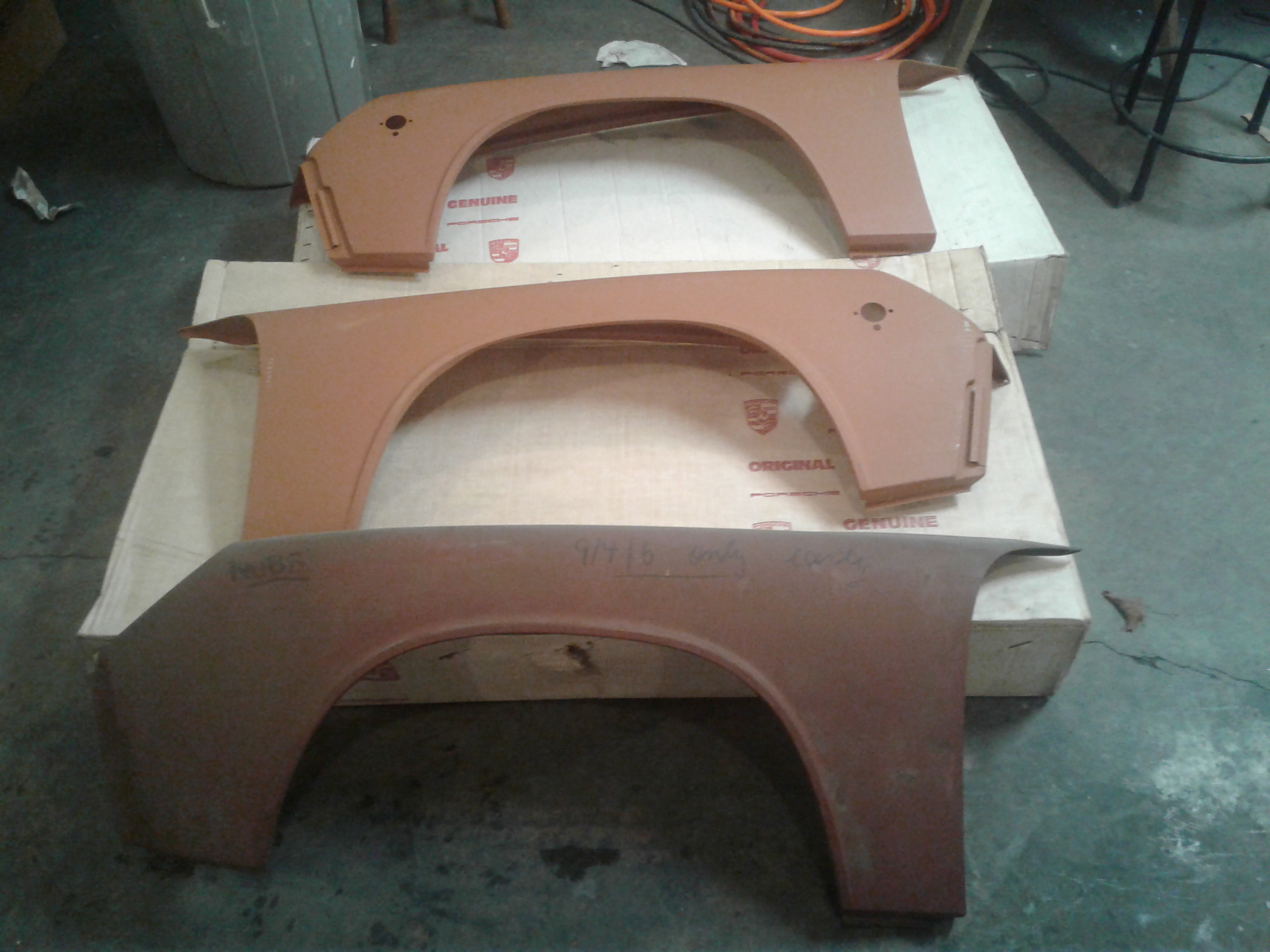

I've had a few setbacks In the last couple years. Hope to get an RFN soon so I can spend more time in the shop. I'm not going to comment on that further for now.
I wanted to include a special thank you to Glenn Stazak. He helped me score a set on NOS front fenders! Wooo hoo!
I now have a left side NOS Euro fender which I will be using on Juergen's car and a set of NOS fenders for my 6. There are still in the factory boxes!

rick 918-S   These are late fenders. Couple small differences t...   Oct 30 2017, 02:41 AM
