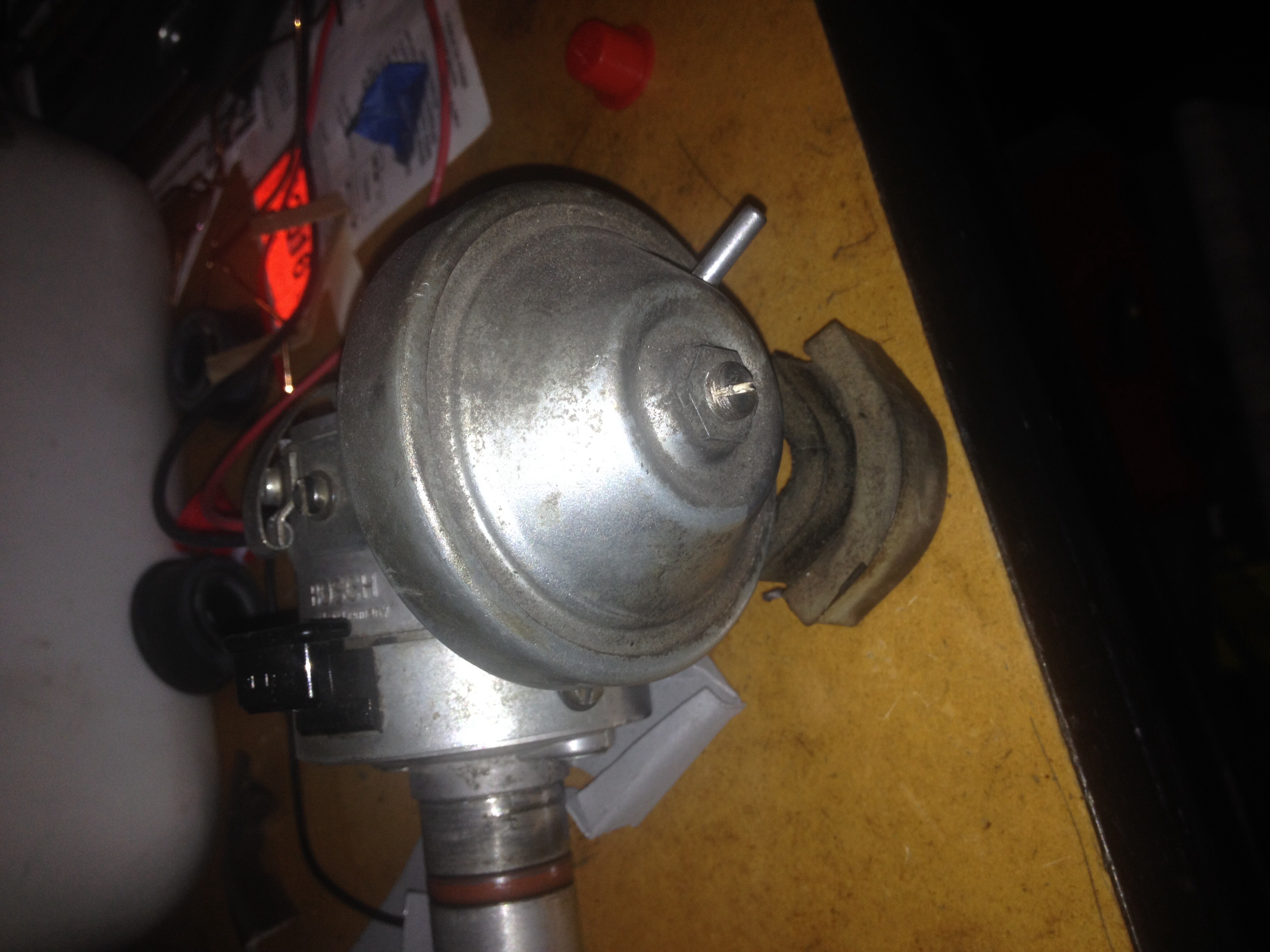

Got the 123Ignition yesterday, I pushed all of my projects back!
"Sorry granny I'll get to those bearings on your heart/lung machine soon, I promise."
Blocked out 3 hours for the removal and install.
Added about an hour to charge the battery.
Installed as expected, there is a spacer that is necessary for type 4, just slides over the dizzy shaft.
I decided to route the wires and vacuum away from the fan so access to the vacuum nipple was easier, since the vacuum can is gone there's a lot more space.
Followed the instructions but made the mistake of using the TDC 0* instead of the 27* as the basic timing point. I just walked the dizzy CCW until she started!
Didn't do anything other than matched my timing with my idle, I let her run till she settled down.
Just around the block once, ha ha the trailer hitching is GONE!
Responsive throttle, man!

I Rebuilt this dizzy when I built the motor about 15k miles ago.
