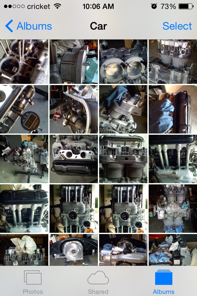

Ok this engine is not stock.
J&E forged pistons, nickie cylinders, 9550 cam and valve train kit.
H rods, lightened and counterweighted crank, 8.3:1 compression ratio.
Lightened flywheel, built by me, D Jet tuned by me.

mgphoto   I Rebuilt this dizzy when I built the motor about ...   Oct 31 2017, 10:49 AM
mgphoto   Ok this engine is not stock. J&E forged ...   Oct 31 2017, 11:16 AM
