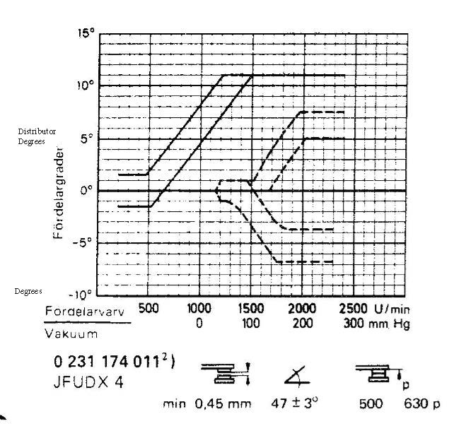

Not sure this is helpful but attached is the curve for the stock dizzy. Note that everything is show as 1/2 of the value.
This corresponds to the 123 chart of showing a max of 22 degrees advance for the 914 dizzy.
I struggled with this 22 vs 27 degrees but it makes sense as at idle your timing would have to be a certain number of degrees BTDC so the re is no need for 27 degrees of advance in the dizzy.
I would suspect that at times you are running leaner that you would like and the high octane worked with your build to keep it from pinging.
If your MPS is adjustable, I would try making it richer by loosening the inner screw alone. While this will make both the Part-Load Mixture Full-Load Mixture richer, it may have an impact on the pinging at standard advance settings. Of course, the only way to tell if it is lean is by having a AFR.
