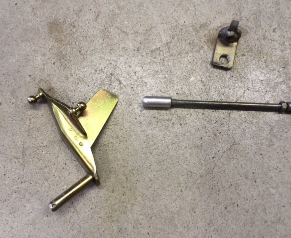

Received my Manual throttle assembly from 914 Rubber and it looks great! But no specific instruction regarding the “Shark Fin” and I have not seen a real one up close. I understand where and how the lever and rod go that's no problem.
Did some poking around here on the site (IMG:style_emoticons/default/type.gif) where I thought I might see pictures but I did not see the small “shark fin” and how and where exactly it goes on the gas pedal. (IMG:style_emoticons/default/idea.gif)
Does anybody have a good picture of the "Shark Fin" installed either real original 914-6 or 914 Rubber version?
Of course I had just got all the pedal cables hooked up and adjusted when I received the assembly not understanding how the hand throttle actually worked. I’m thinking the whole pedal assembly has to come out. (IMG:style_emoticons/default/confused24.gif)
“Shark Fin” is on the far left. Thanks!

Here's the "shark fin" welded on to the pedal throttle arm.
Clear as mud? (IMG:style_emoticons/default/smile.gif)
And yes....likely easier to take the whole pedal assembly out to do this.

Thank you, (IMG:style_emoticons/default/beerchug.gif) thank you (IMG:style_emoticons/default/beerchug.gif) , thank you (IMG:style_emoticons/default/beerchug.gif) ! A picture is worth a thousand words.
I would have certainly have put it upside down having no clue which way the shark was swimming, but your picture says it all! (IMG:style_emoticons/default/first.gif)
