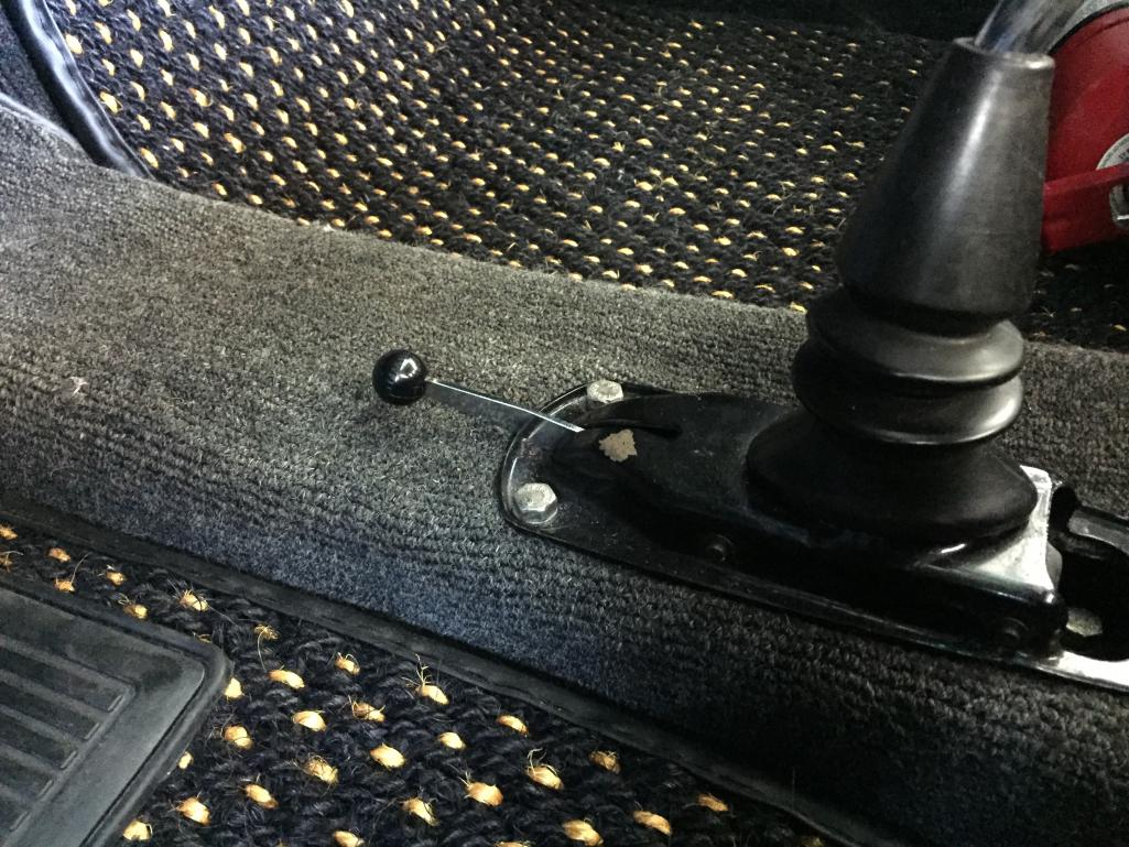

Just for kicks, this is my set up. Genuine 914-6 set-up in the tunnel and on the pedal. I used a 911 lever for it, and there is a knob Porsche made that says "Throttle" for my type of lever too. I think Eric Shea's car has one....?
It is good for cold starts, and it does work for "cruise control."
