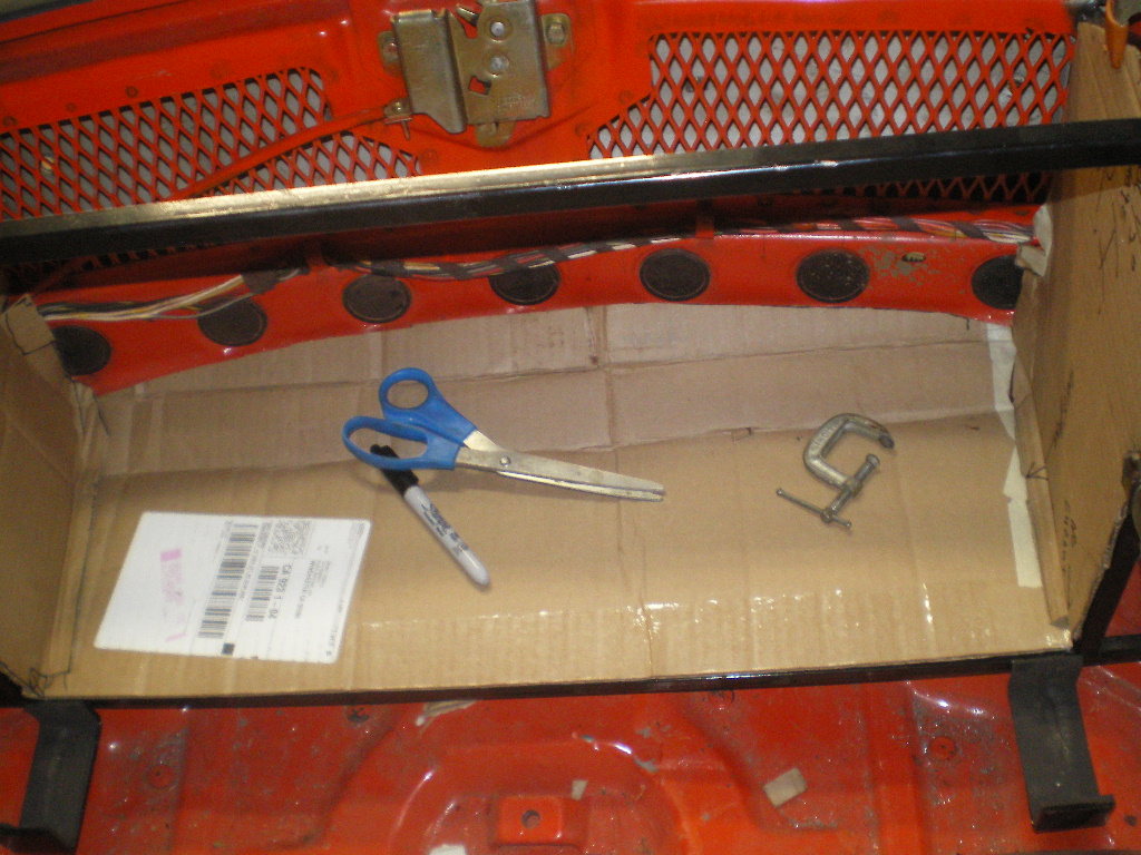

Made the rough cut templates out of cardboard. They give me a general idea of the size to cut the second set out of poster board which is easier to bend and fit.

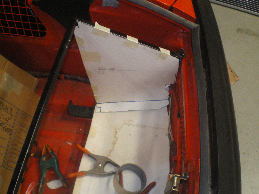

Then the poster board templates are fit and trimmed.
Bottom piece checked in place

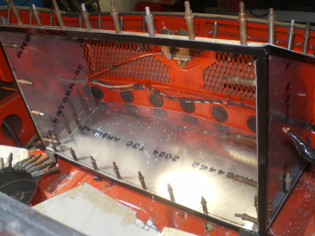

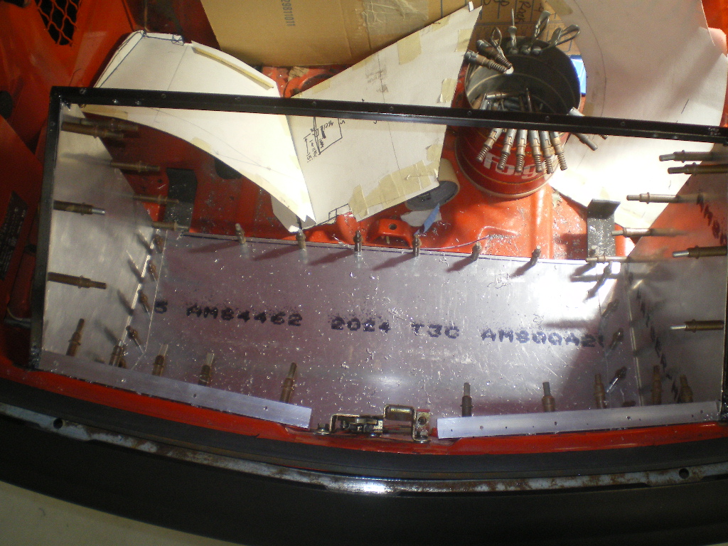

Then the sides and top pieces are cut, trimmed and clecoed in place

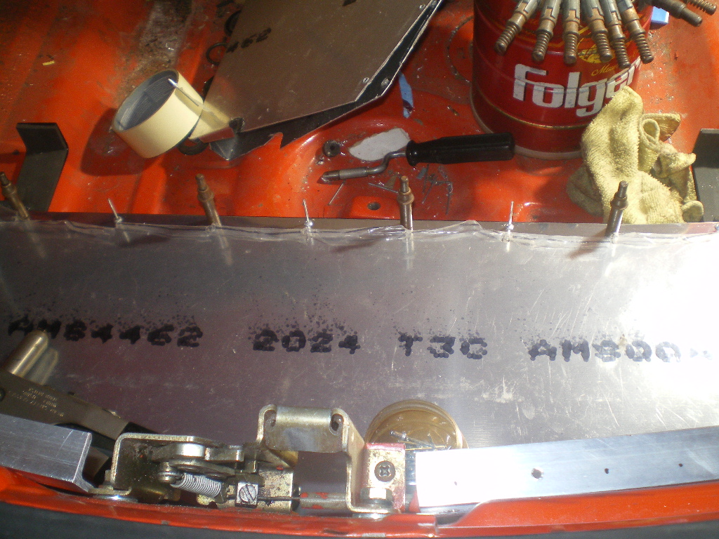

Next I riveted the bottom to the frame but can't rivet the remaining pieces in because the right side headlight harness passes thru and I haven't checked out the electrical yet.
Reinstalled the radiator to check fit
