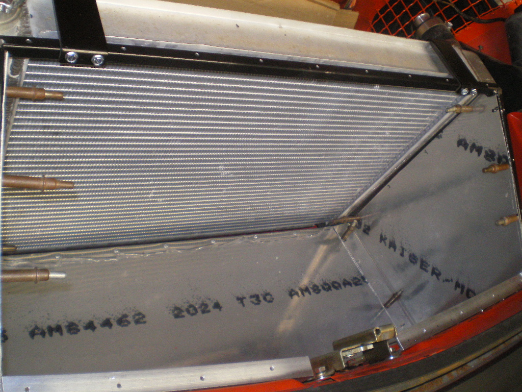

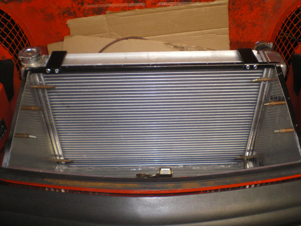

The side will get a trim flange to fill the void once the side pieces are riveted in place.
A shot from the front

914350   I love the way you mounted the radiator. The shrou...   Dec 13 2017, 11:18 AM
76-914   I love the way you mounted the radiator. The shro...   Dec 13 2017, 06:31 PM

76-914   I forgot to add these pic's once I closed up t...   Jan 14 2018, 01:39 PM
mepstein   Very clean looking. Is that an RH setup?   Jan 14 2018, 01:49 PM
Mueller   Nice radiator setup...might want to add a bead or ...   Jan 14 2018, 02:31 PM
dakotaewing   Try some Denatured alcohol to the cover to remove ...   Jan 14 2018, 05:42 PM

76-914   Very clean looking. Is that an RH setup? Don...   Jan 15 2018, 09:19 AM
