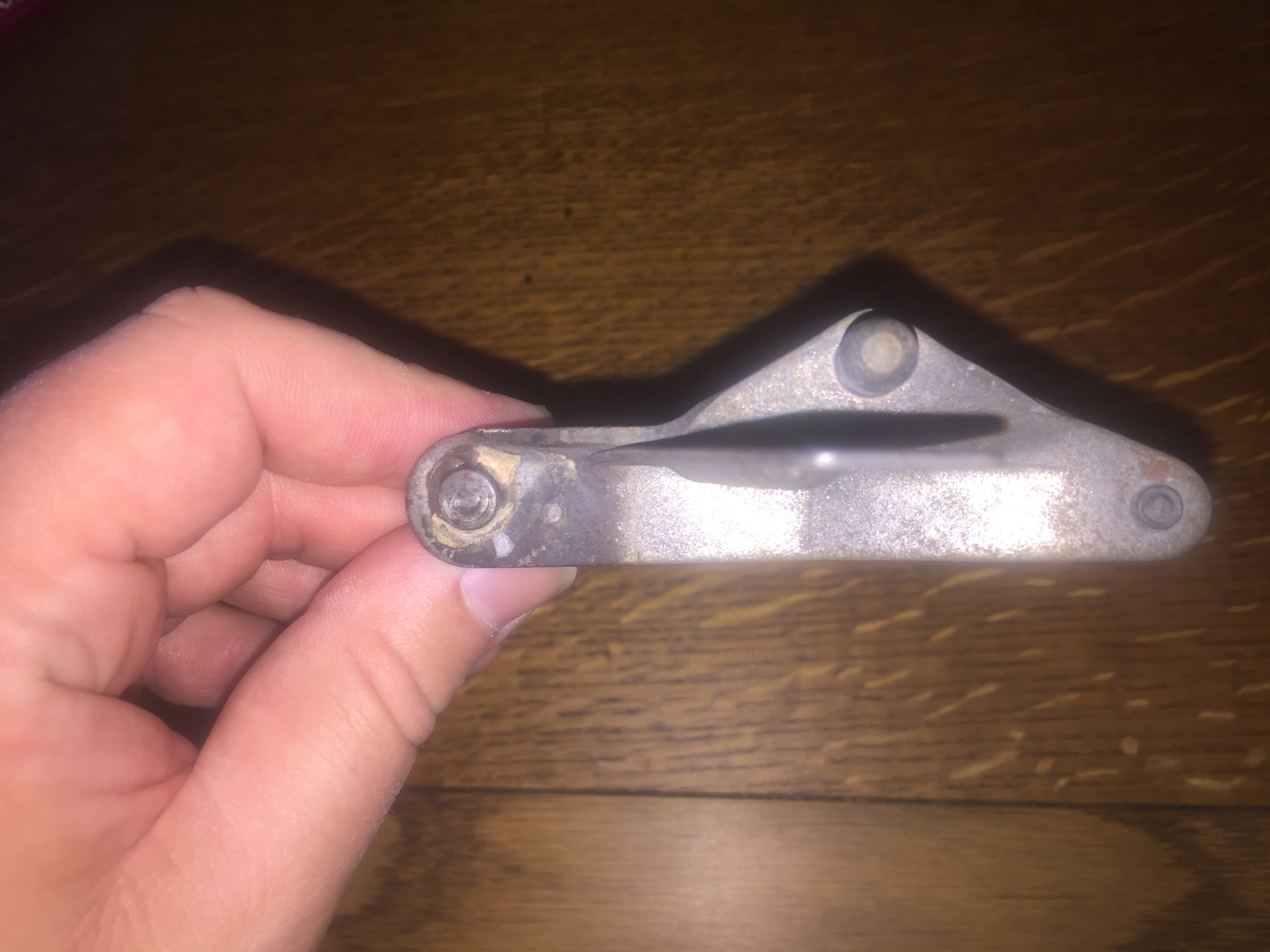

Received my Manual throttle assembly from 914 Rubber and it looks great! But no specific instruction regarding the “Shark Fin” and I have not seen a real one up close. I understand where and how the lever and rod go that's no problem.
Did some poking around here on the site (IMG:style_emoticons/default/type.gif) where I thought I might see pictures but I did not see the small “shark fin” and how and where exactly it goes on the gas pedal. (IMG:style_emoticons/default/idea.gif)
Does anybody have a good picture of the "Shark Fin" installed either real original 914-6 or 914 Rubber version?
Of course I had just got all the pedal cables hooked up and adjusted when I received the assembly not understanding how the hand throttle actually worked. I’m thinking the whole pedal assembly has to come out. (IMG:style_emoticons/default/confused24.gif)
“Shark Fin” is on the far left. Thanks!

Mikey914   You for a install without welding, you can drill 2...   Oct 31 2017, 09:35 PM
raynekat   Here's the "shark fin" welded on to ...   Nov 1 2017, 12:47 AM

SixerJ   Here you go, I tucked the corner of the wood templ...   Nov 1 2017, 11:34 AM

Lucky9146   Update! Was able to surgically extract the le...   Nov 2 2017, 11:08 PM
SixerJ   Jim here you go. As you can see the fin is not har...   Nov 3 2017, 01:47 AM
Lucky9146   Jim here you go. As you can see the fin is not ha...   Nov 3 2017, 09:23 AM
