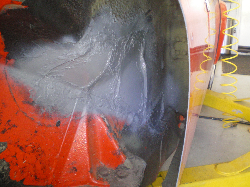

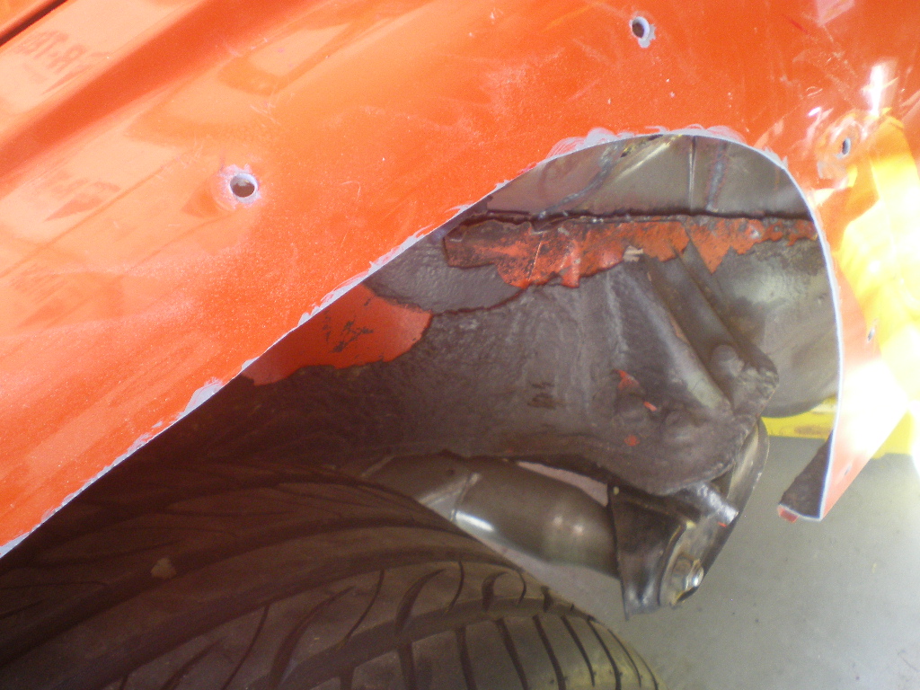

I spent this morning doing a little house cleaning. When the Hell Hole wall was patched it was done so using 3-4 smaller pieces that were welded together with lap joints. Not the prettiest but functional. I had seen this in the photos posted prior to buying the car. Before I reattached the flare I decided to take a look under some very thick undercoating and found Mr. Ugly staring back at me! There is also another small patch closer to the front that you can see in the after pics. Glad I looked or this would have needed another repair in a few years.
I cleaned the metal with a wire brush on my grinder then primed the recessed and exposed areas as well. Next I filled the voids and lap joints with Wurth's
Seam Sealer followed up with 2 coats of primer. Doesn't look like 3 hours work but it was.

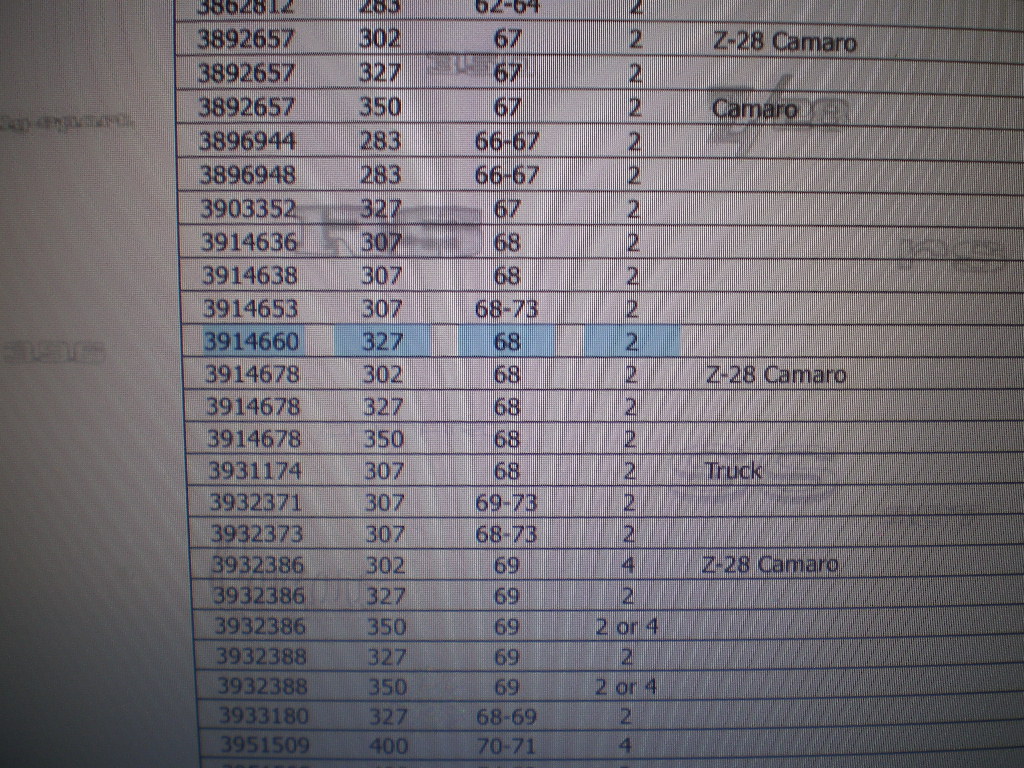

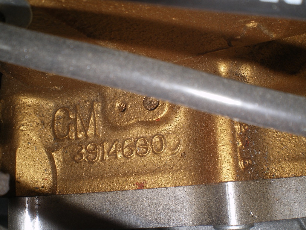

Also took a good pic of the block casting #

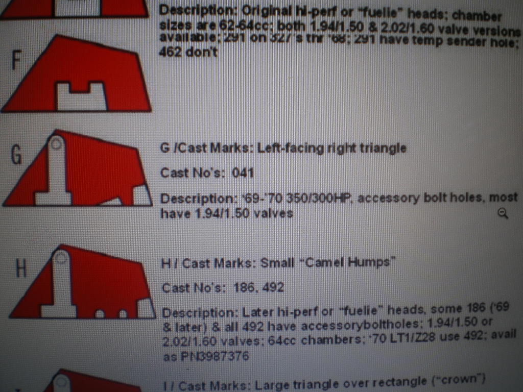

So. it's a
Head casting ID but I haven't lifted a valve cover to get the casting #
So apparently it's "G" which is a 350 head. Will the 350 mate to a 327?. That's why the casting number will be more accurate. I guess it's possible that some modification was done.
Nice, Kent, a 914 part# on your V-8!
