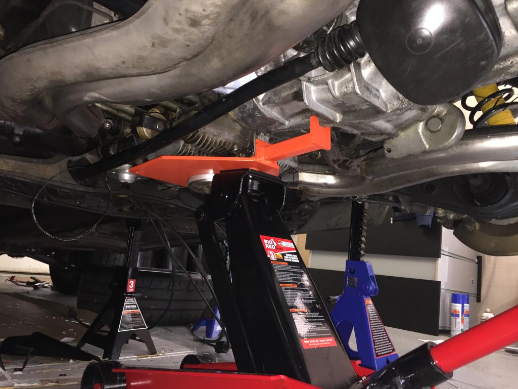

using the bracket from tangerine - it went well except it appears the motor mounts have never been changed and the engine bar mount bolt on one side snapped due to being rusted in the bar - iv not removed a motor but i see here that my motor mounta were not attached to he motor- just resting on the rubber mounts- crazy wndwr how long those have been in this condition?

mepstein   when i pulled the engine on my 4, i jacked up the ...   Oct 31 2017, 12:34 PM
Philip W.   so last night I did a dry run fit to see if jack g...   Oct 31 2017, 01:36 PM
Philip W.   using the bracket from tangerine - it went well ex...   Nov 4 2017, 07:57 PM
Racer Chris   using the bracket from tangerine - So you didn...   Nov 8 2017, 07:23 AM
Philip W.   using the bracket from tangerine - So you didn...   Nov 8 2017, 12:45 PM
