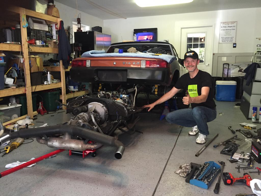

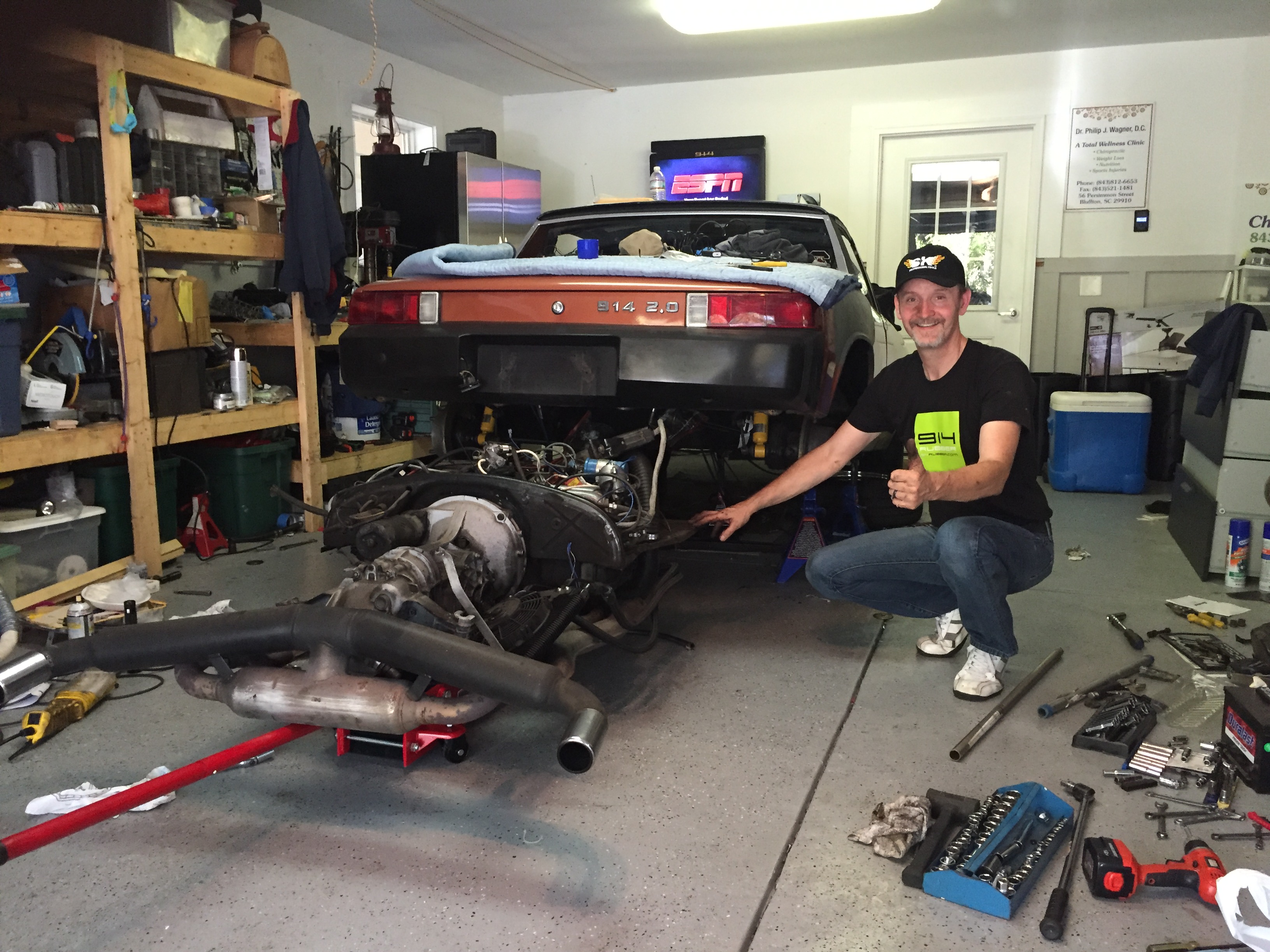

i dont normally do pictures of myself , thought it might be appropriate to document - my friend Jim came over and helped out - went a lot easier with an extra hand! he still doesnt have a 914 but has a background as a aricraft mechanic very helpful
