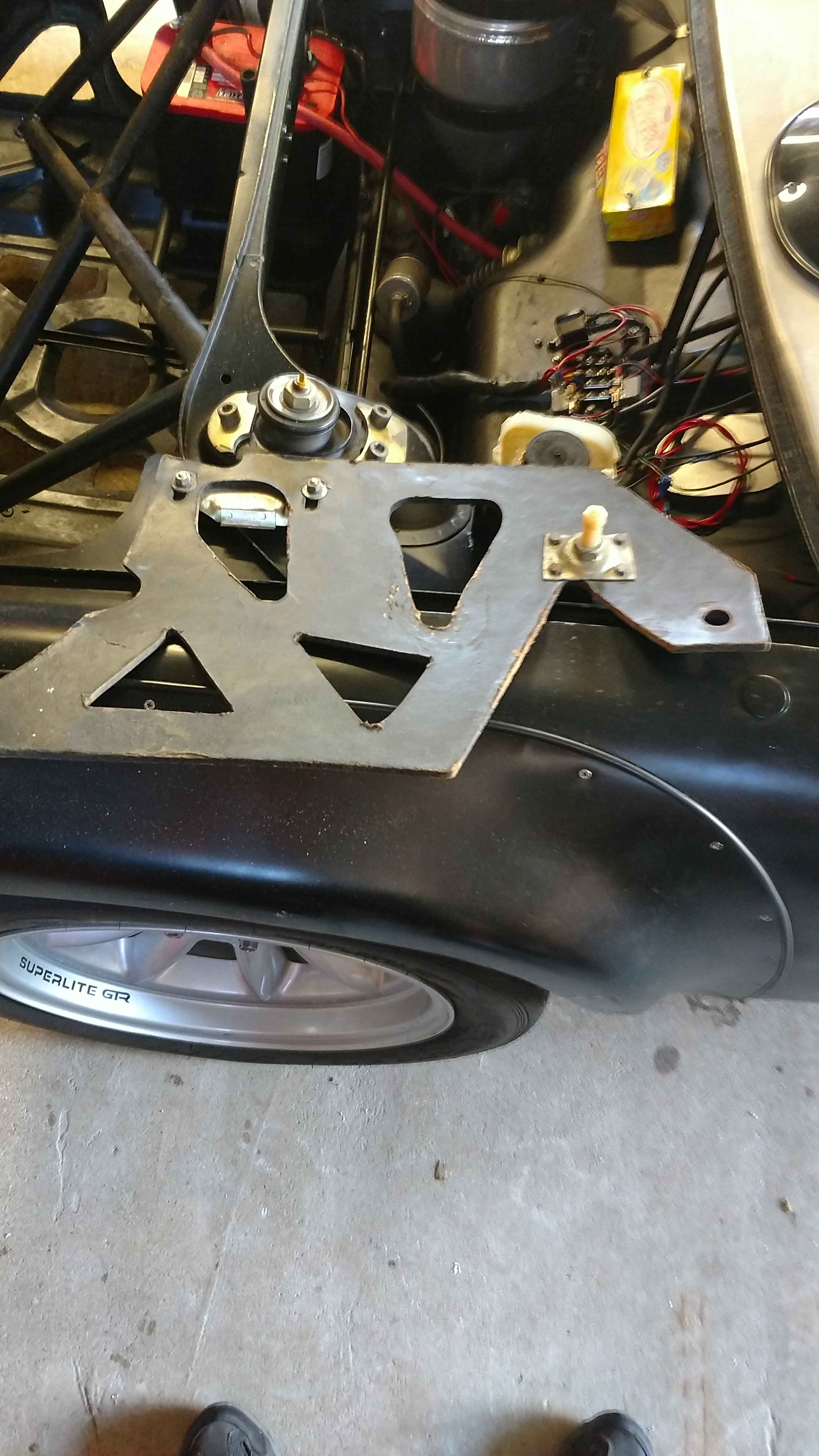

914 Ranch   Working on the brackets today. Some progress. F...   Mar 4 2019, 09:52 AM
