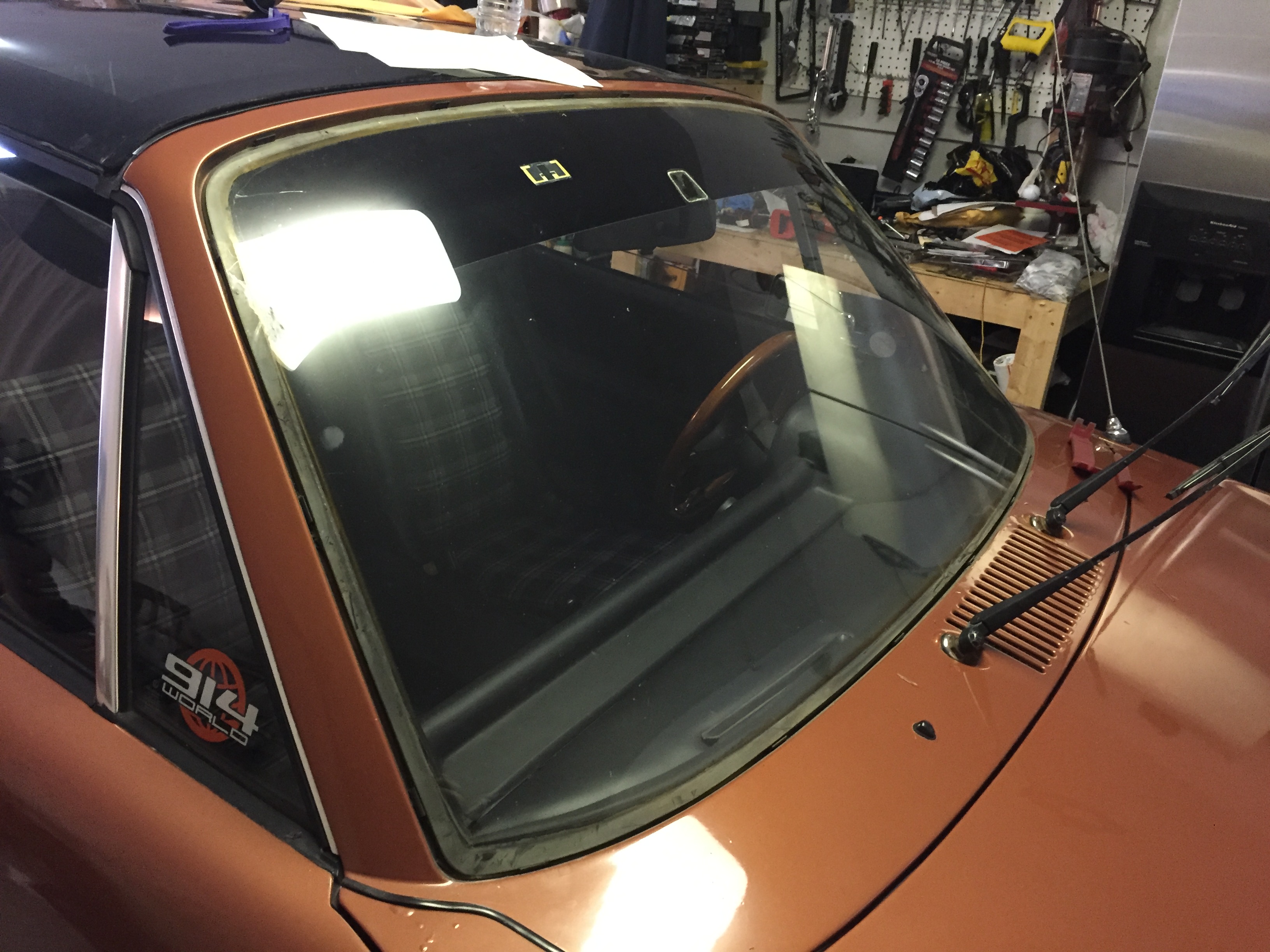

also i have the window trim off - completely loose , so easy to remove only thing holding it in place was the chrome trim
