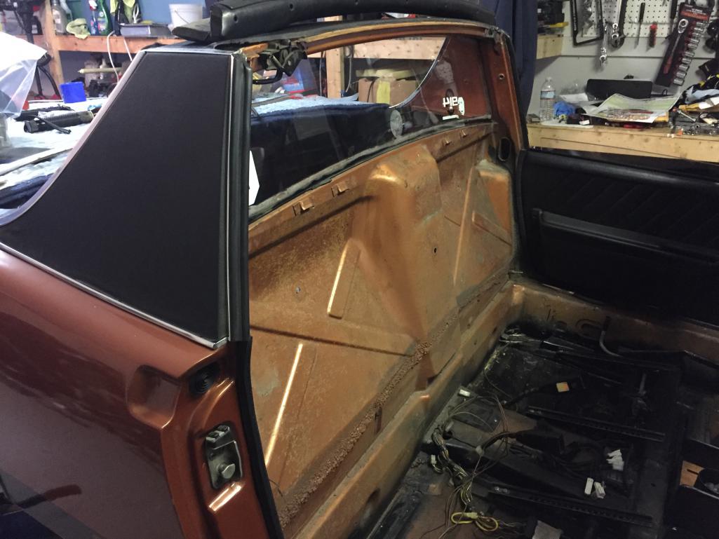

interior partly out

Philip W.   interior partly out   Nov 5 2017, 05:32 PM
Philip W.   one small sopt of rust thru on the targa area on ...   Nov 5 2017, 05:37 PM
Philip W.   rear window out, no rust surprises here , pretty c...   Nov 5 2017, 06:08 PM
mepstein   The sails had foam so they rust from the inside ou...   Nov 5 2017, 06:08 PM
Philip W.   The sails had foam so they rust from the inside o...   Nov 5 2017, 06:11 PM
