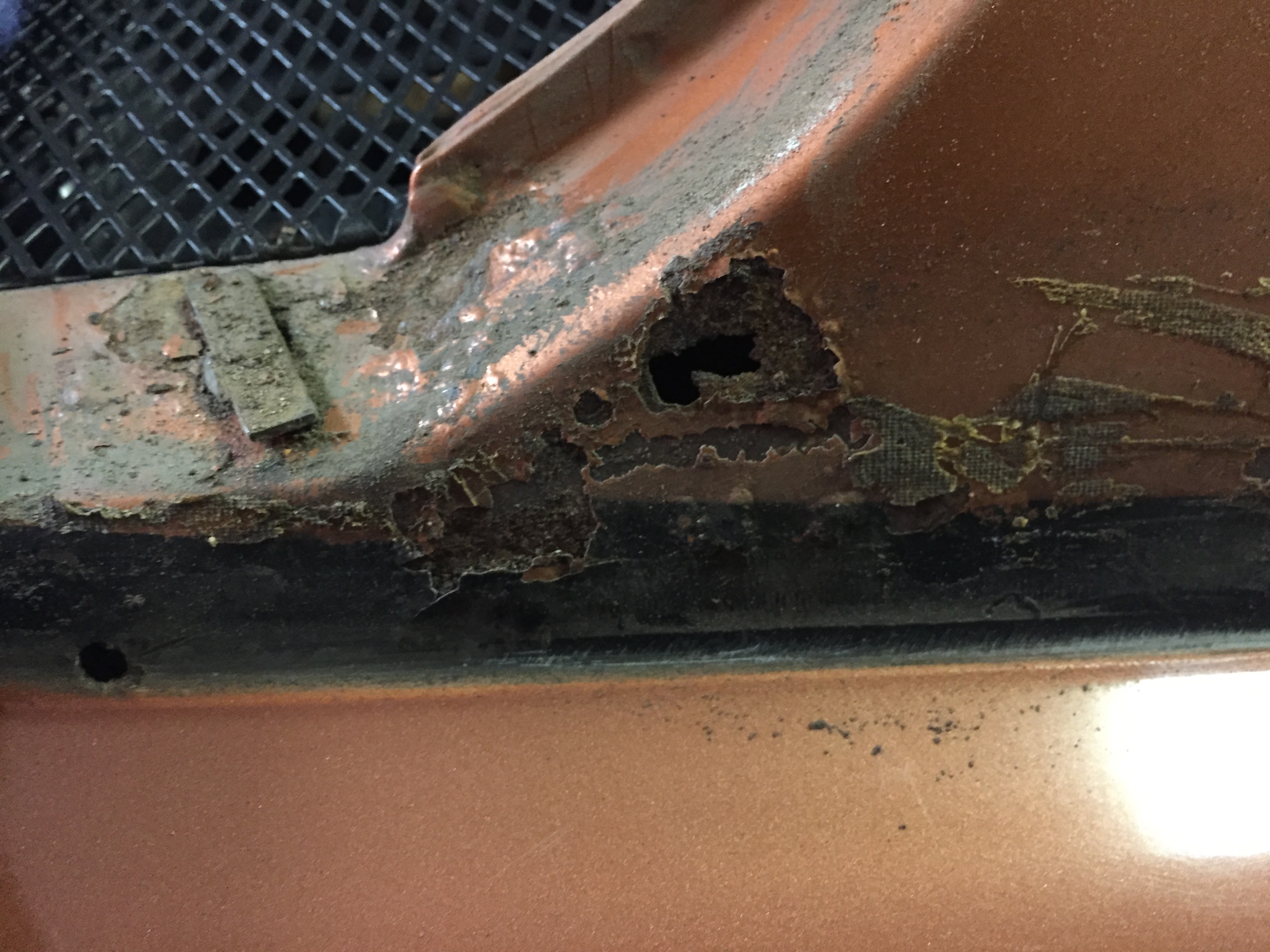

one small sopt of rust thru on the targa area on right side,
any advice here for my guy when he fixes that? should spray the inside with rust reformer and some type if epoxy primer?

Philip W.   one small sopt of rust thru on the targa area on ...   Nov 5 2017, 05:37 PM
Philip W.   rear window out, no rust surprises here , pretty c...   Nov 5 2017, 06:08 PM
mepstein   The sails had foam so they rust from the inside ou...   Nov 5 2017, 06:08 PM
