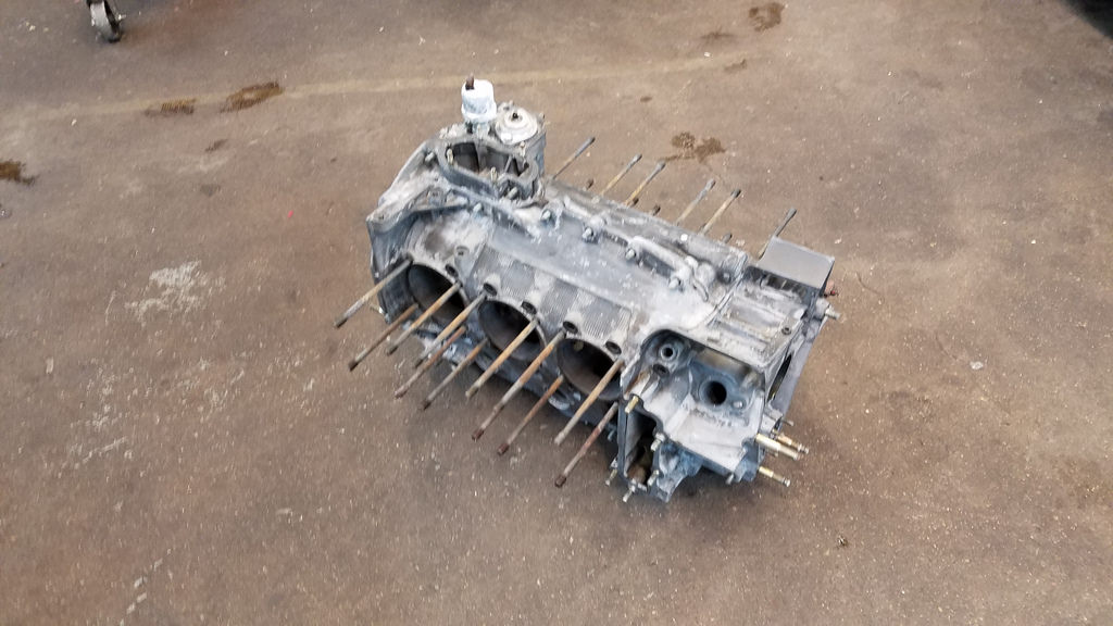

A friend of mine owns Flat Six in Minneapolis, MN. About 40 minutes from me. Sent him a message inquiring about core 6 cylinders and ended up coming home with this.
(IMG:http://www.914world.com/bbs2/uploads_offsite/c1.staticflickr.com-19709-1497540075.3.jpg)
It's a 2.2 from a 911T, the 125hp version. On top are a pair of Zenith carbs that will work fine for my purposes after a complete rebuild. It turns over smoothly and you can feel when it comes up on compression. Good signs for an otherwise unknown engine. If you had followed along in my build thread you'll know that I got some amazing deals, both for parts and for the car itself. The 6 does not disappoint in that regard, but I wont be sharing the details here.
Perhaps the best part of the deal is that he said if I get into it and find that anything is FUBAR, I can get a no-charge replacement from him since he has Parted several 2.2's. Again, this is a friend, I don't expect him to do this for anyone.
With his help we laid out a build plan. Going to get the T cams reground to the E profiles paired with higher compression pistons. Cylinders are iron so I can bore those. Goal is around 150ish hp. It'll be a "budget" build in the sense that I'm not going for huge power and will be doing the assembly/cleaning myself. I won't be cutting corners with machine work and inspection though.
I will be mating it with a side-shift trans using the early 911 flywheel. flywheel and bulkhead weld-in mount already on order. It's not likely that I'll be doing a conventional 914-6 oil tank, it just seems like so much money for what you get. We will see though, as time progresses I may change my mind.
This will be a driver, not trying to make it a show queen or original to a real 914-6. I want to keep the utility of both trunks but I want the mechanicals to be functionally excellent.

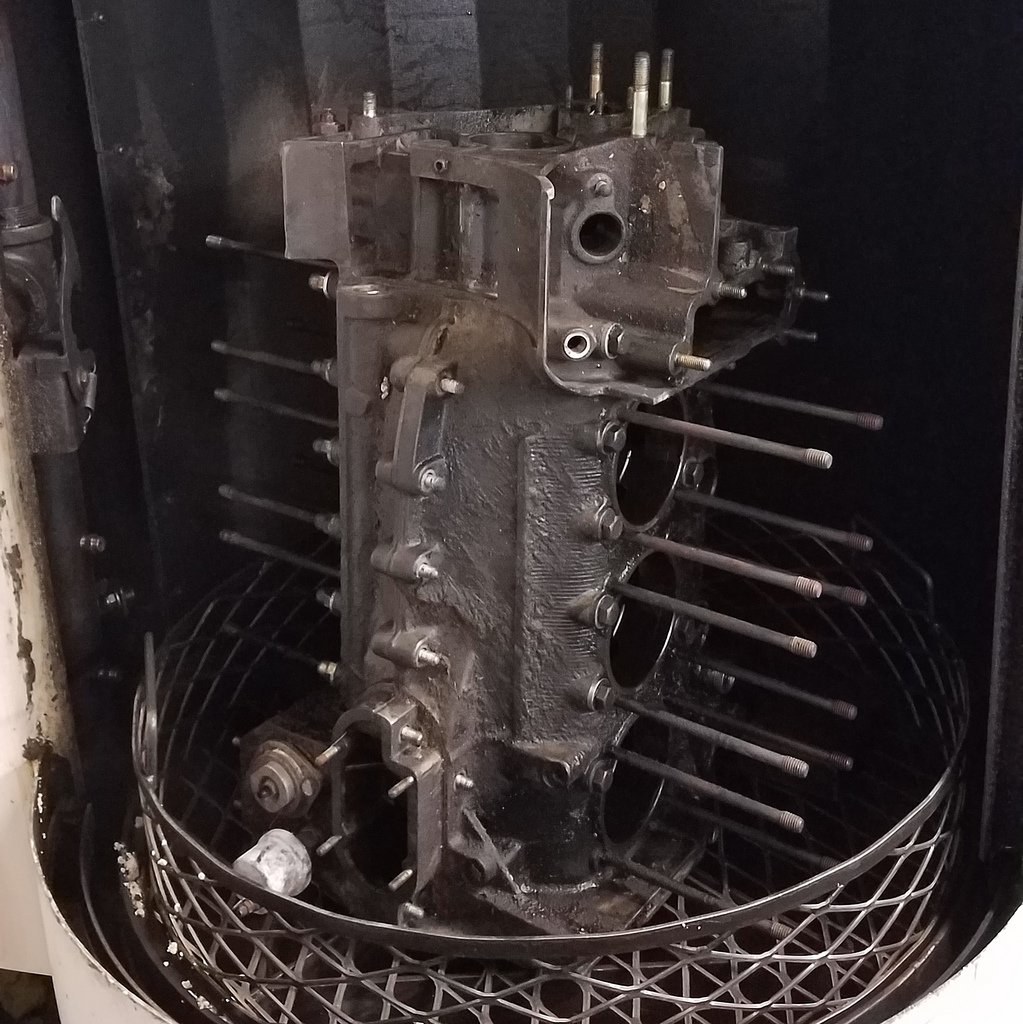

Update time, been holding off on moving too far forward until I get a chance to 3D model the case, but I did get something done.
Swung down to a friends shop and stuck it in a big parts washer he has.
(IMG:http://www.914world.com/bbs2/uploads_offsite/c1.staticflickr.com-19709-1509978806.1.jpg)
The inside is pretty clean so I stuck the two case halves in lightly bolted together.
Pic is a bit blurry, thanks potato phone, but it's mostly cleaned up now.
(IMG:http://www.914world.com/bbs2/uploads_offsite/c1.staticflickr.com-19709-1509978806.2.jpg)
I'm going to go over in by hand and clean a bit more, but now it's ready for more inspection and for me to model it.
