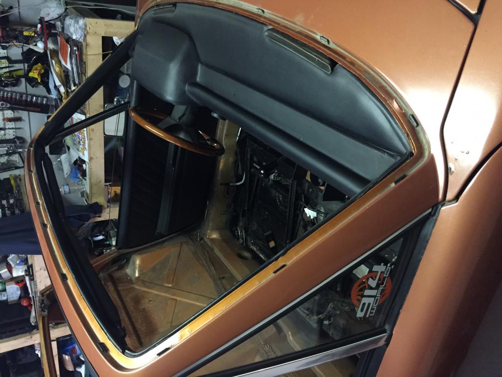

more good news!! window is out , no rust under seal-

Philip W.   more good news!! window is out , no rust u...   Nov 7 2017, 06:28 PM
Perry Kiehl   Lookin' good Phil! Looks like you are doi...   Nov 7 2017, 08:52 PM
Philip W.   Perry, i've been encouraged by finding less r...   Nov 7 2017, 09:37 PM
