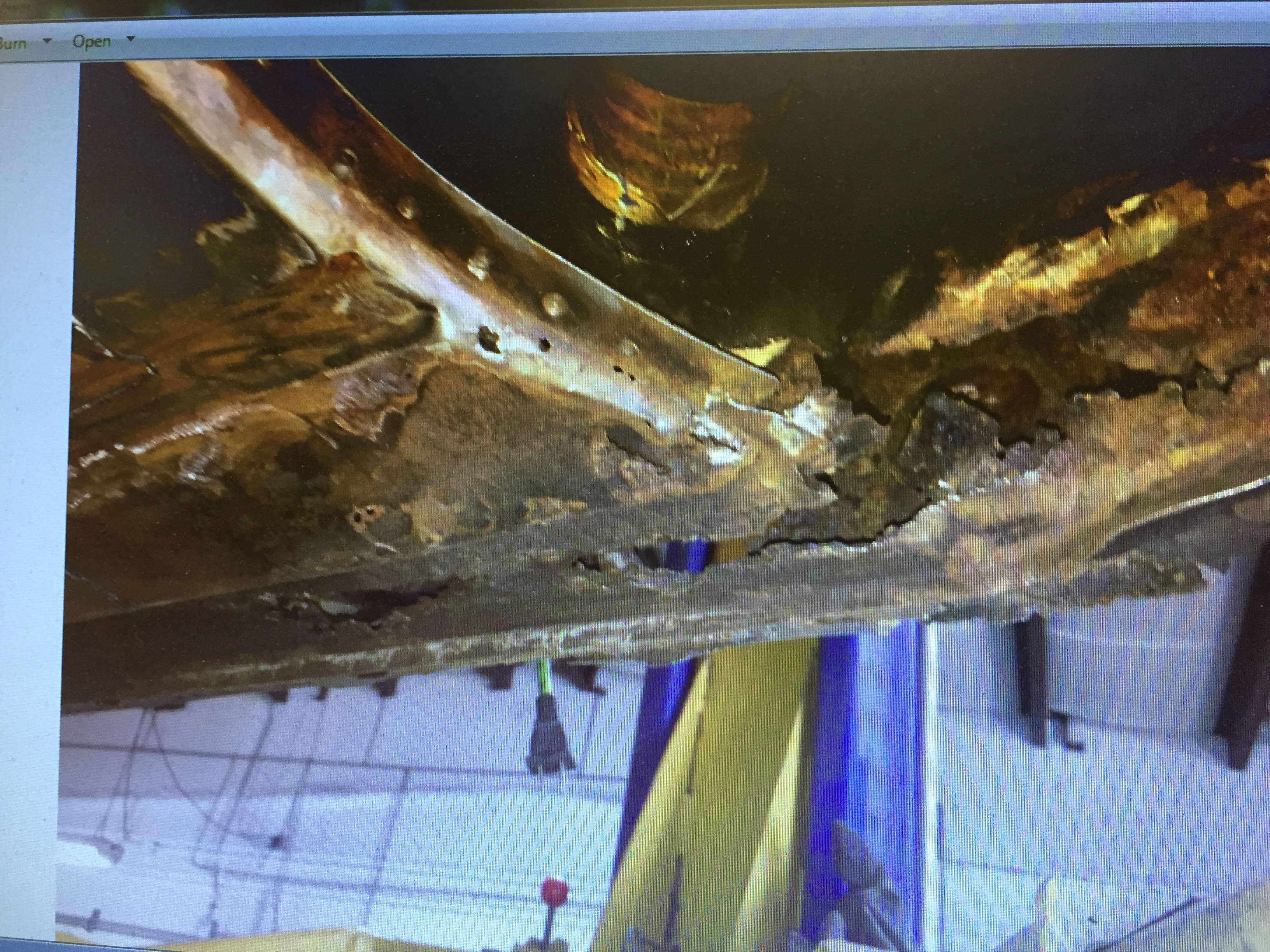

They will be sanding it down by hand to the original primer and fixing and missed rust etc not repaired last year- as previously documented the floor pan rust jack points longs and pedal area were all repaired by Chis and Ed at Tangerine Racing in 2016. they also repaire the fender lips that were bent and damaged and massaged the rear fenders out to get room for the 7" fuchs. Now those will be smoothed out the rest of the way.

just a reminder of some of the challenges along the way- rear floor , jack points and rear outer longs were swiss cheese thanks to the Ohio winters i believe
