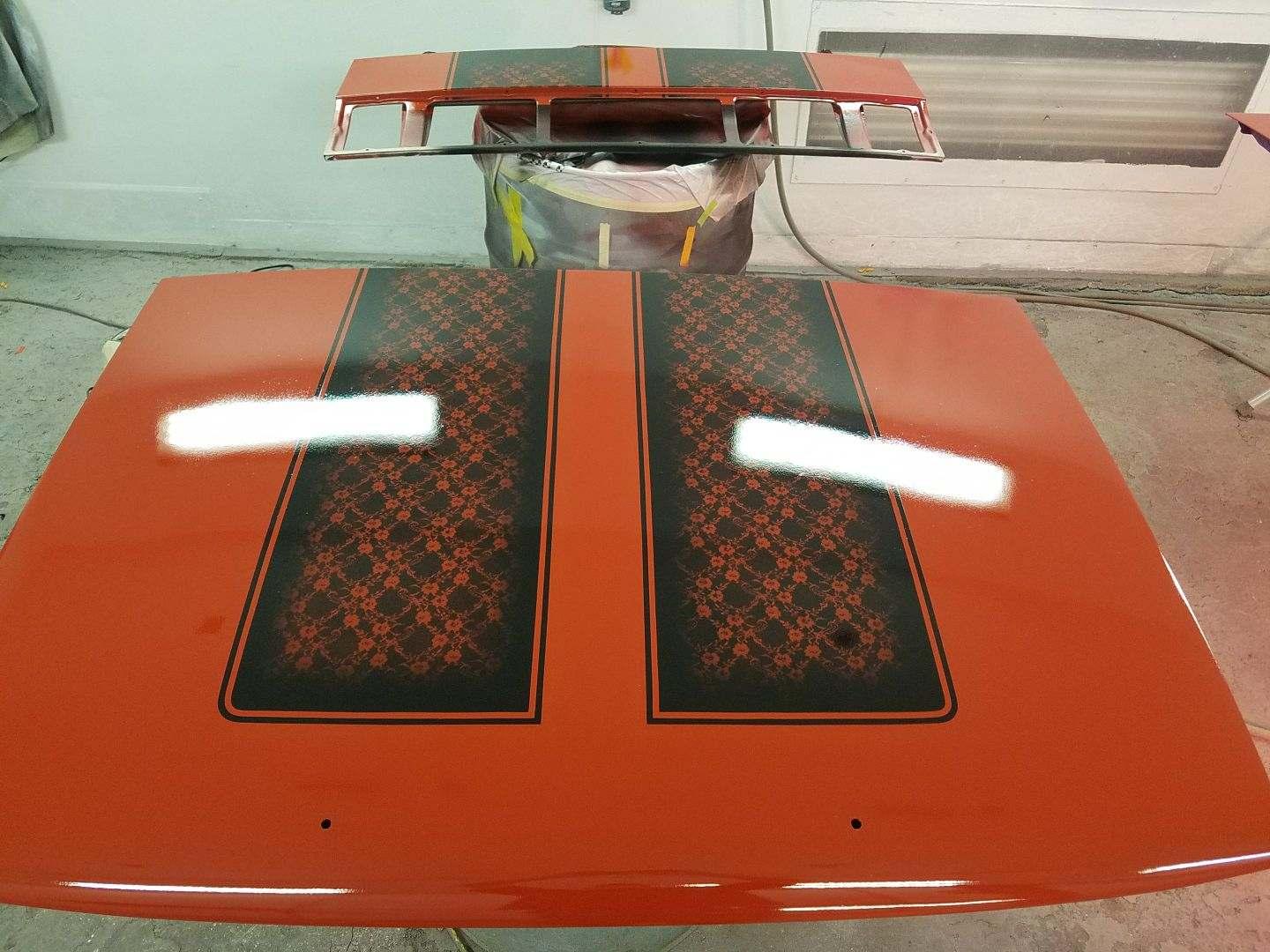

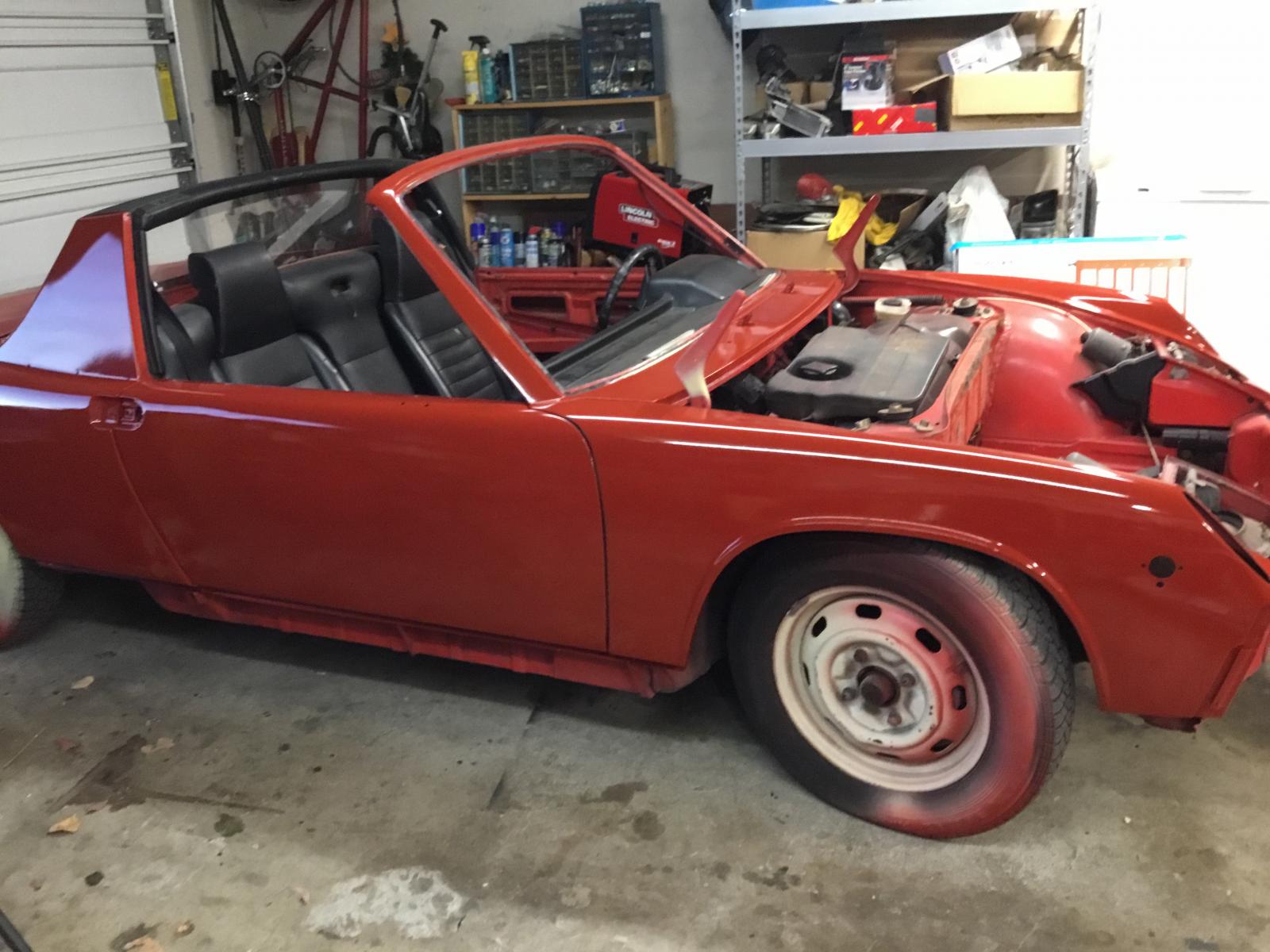

Mikedrevguy   Wow. Has it been so long?? Lots changed. HPMX 44 i...   Nov 8 2017, 10:21 AM
Mikedrevguy   http://www.914world.com/bbs2/uploads_offsite/www.t...   Nov 8 2017, 10:29 AM

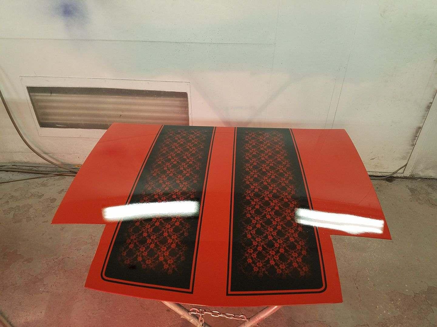

Mikedrevguy   http://www.914world.com/bbs2/uploads_offsite/www.t...   Nov 15 2017, 09:22 AM
Mueller   I dig the stripes...   Nov 15 2017, 09:58 AM
Mikedrevguy   Thanks. A product of KingHat Pinstriping   Nov 15 2017, 03:45 PM
