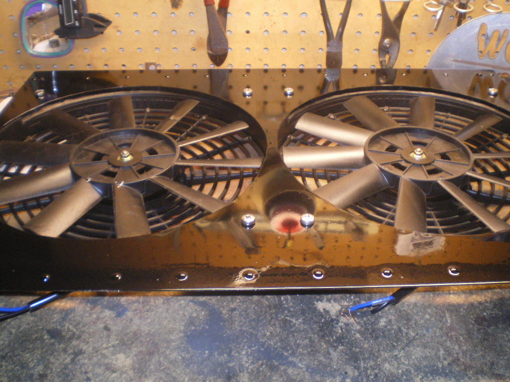

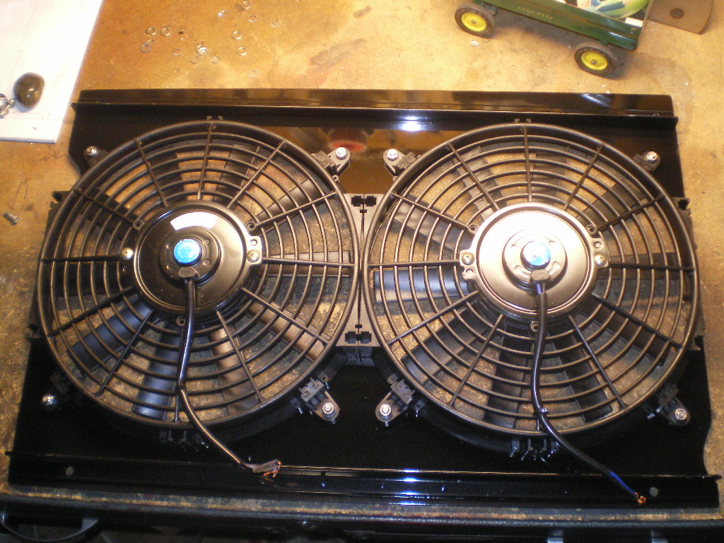

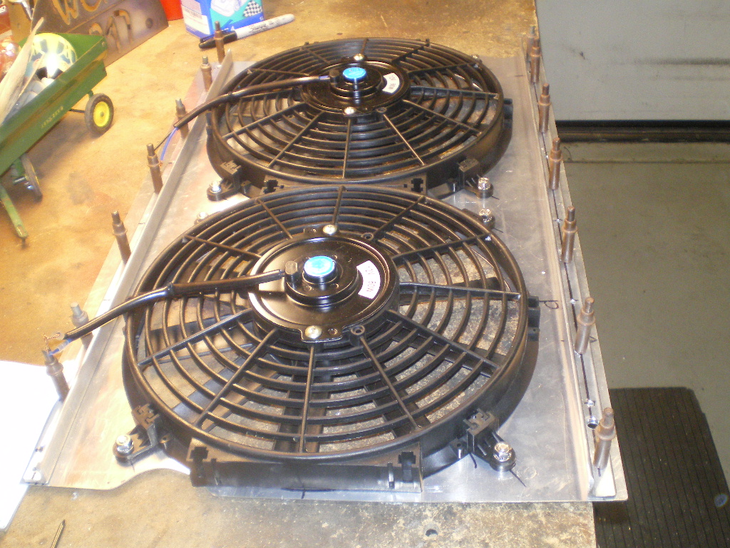

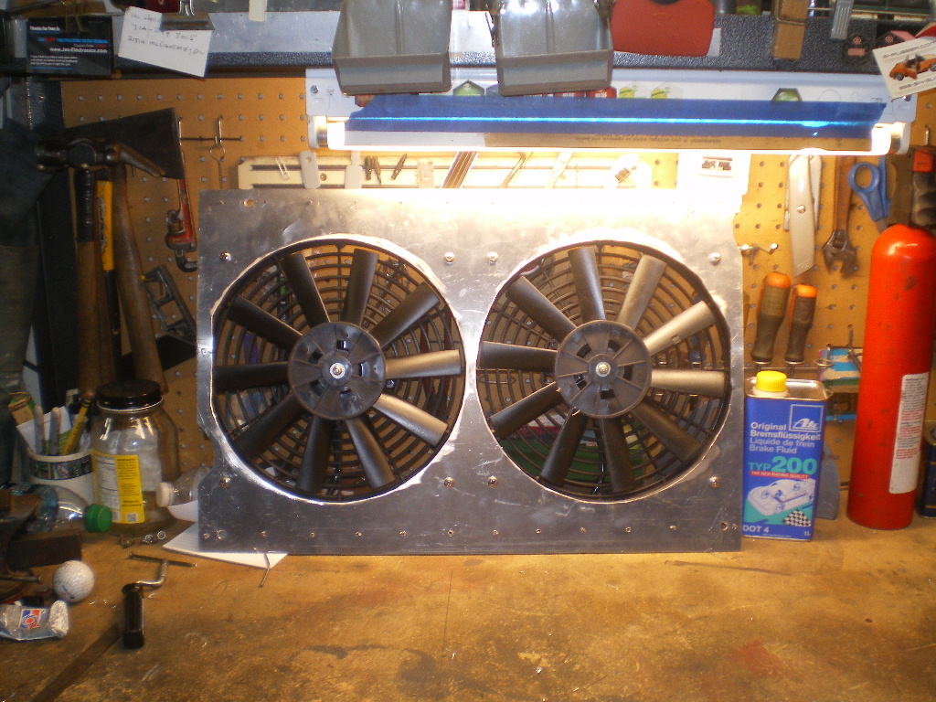

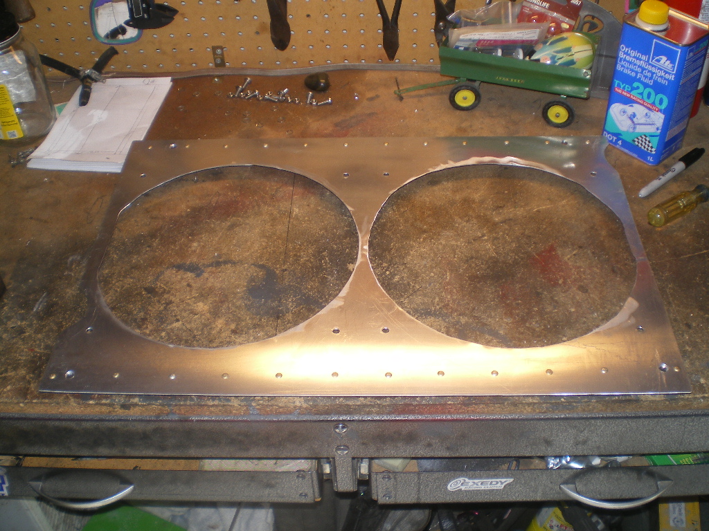

Good eye Mark. I totally missed that. Now where was I? Oh yes, so that's a far as I can go with the plenum until I can get the electrical to the horns and running lights tied in and tested because that harness passes thru the plenum. So it was time to hang those fans. Another good reason to buy the Celica radiator that comes WITH fans. That feature alone will save you 6 hours. I managed to piss off and hour trying to devise a shroud that would mount to the radiator before I pulled my head out of my (IMG:style_emoticons/default/bootyshake.gif) and used the radiator mounts for the shroud as well. Can't believe I didn't see that immediately. I used some 1/4" bolts that came with the car. They do not have a hex head but rather a round thin base. Bob's intention was to weld those to the bottom from which to hang the radiator hoses but I preferred using 6mm SS nuts, bolts and washers like I did on the Suby conversion. The radiator brackets were all on the same vertical plane so it was just a matter of welding one of these threaded pieces to each brace. You can see the top ones but not the bottom where the grey primer is on the bracket.

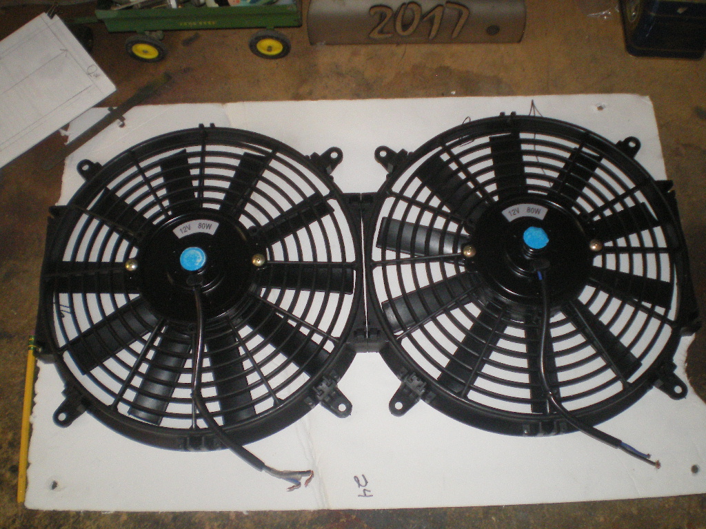

I took a piece of this 1/8" backer board and pressed it against the bolts until they popped thru to mark their location then laid the fans across the template to check for fit. Looked like everything would mount up OK.

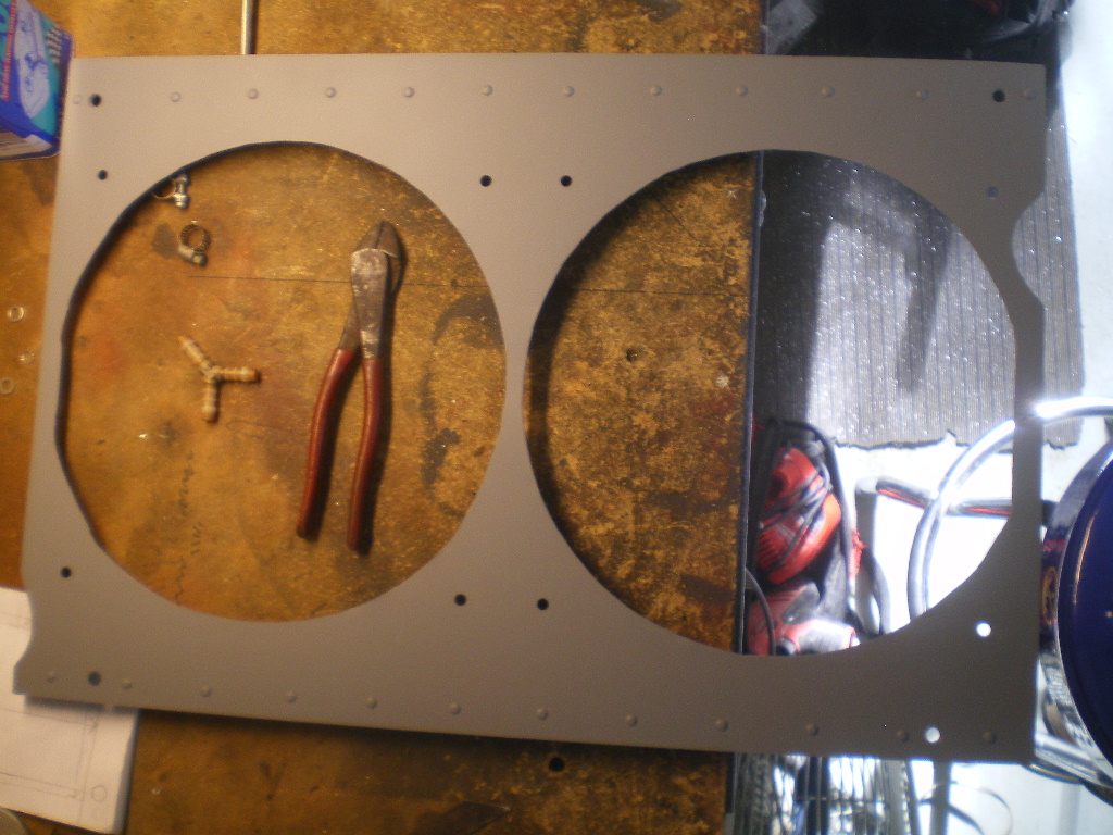

Then I took a piece of .050" aluminum and drilled it to match adding some 3/4" x1/8" filleted (AC grade) angle to stiffen and re-inforce the attach points.
After a quick test fit the shroud was riveted and prepped for painting
Then 2 coats etching primer and 3 coats of paint.
