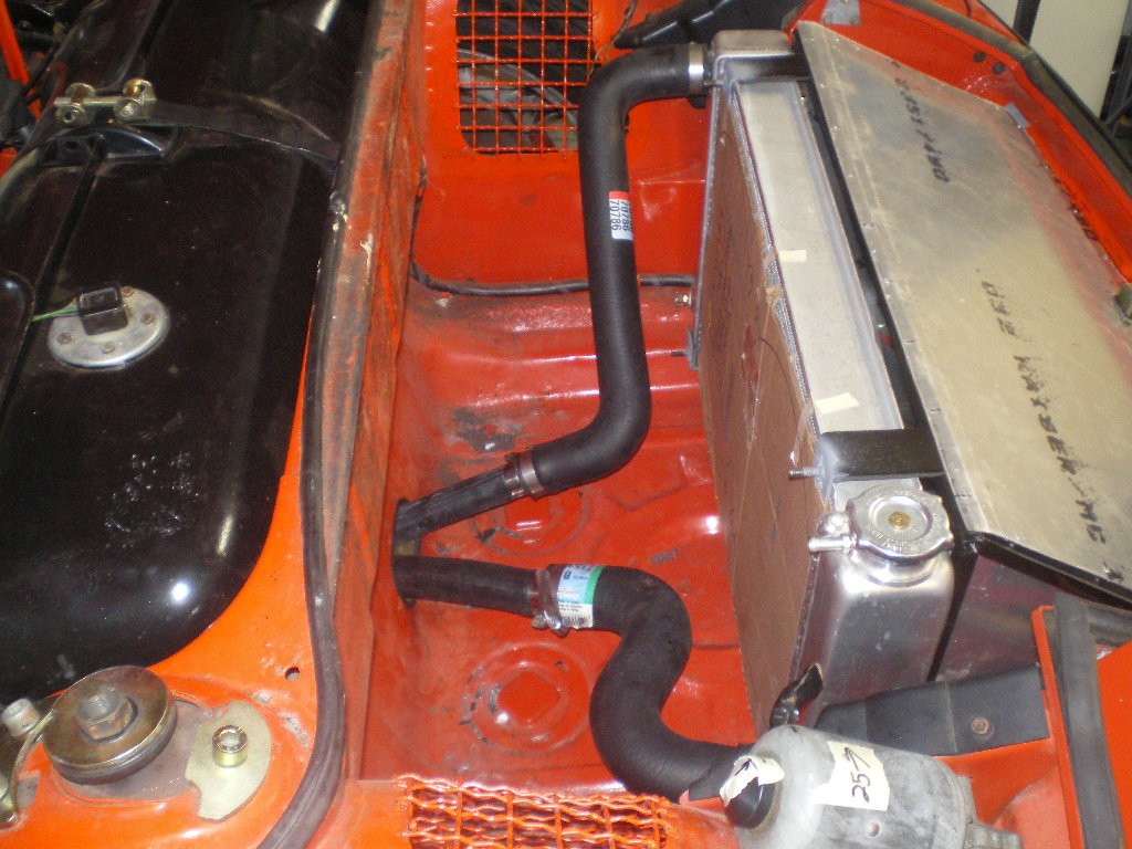

Got'a keep moving if I want to sell this thing in time for Spring Fever. One good thing about posting the pic's is you have a chance to review your work. I just noticed that I have my radiator lines bass-akwards. (IMG:style_emoticons/default/chair.gif) An easy fix no harm done.

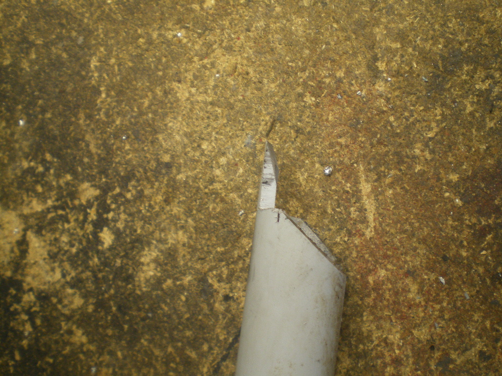

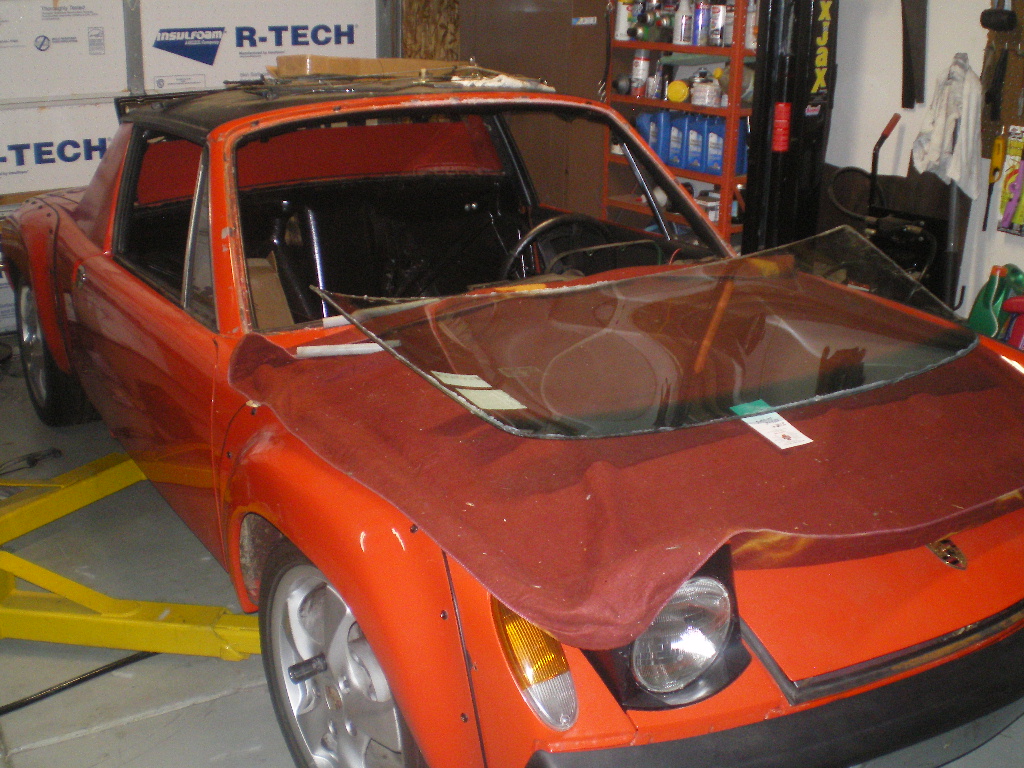

While waiting for the paint to dry on the shroud I worked up the courage to remove the windshield. It was held in place by approximately 11 tubes of silicon. (IMG:style_emoticons/default/lol-2.gif) Once I was able to open up an area large enough to fish a wire through I was able to slice thru it.
This will give you an idea of how much silicon needs to be removed.

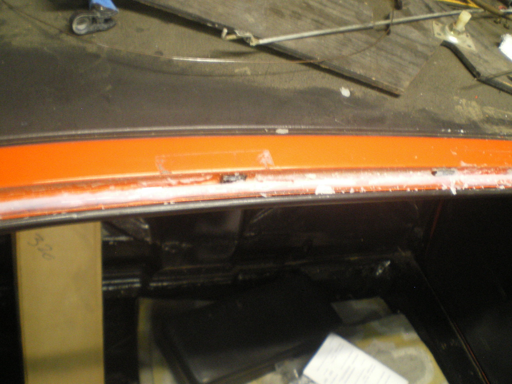

I fashioned the scraper out of some 1/2" PVC conduit and gave it an edge.
It works well. I removed about a 3rd of the caulking in 5 minutes as you can see in this pic. There is a small skim coat that remains in the channel so I'm thinking what would be the smart approach to remove it. Maybe a brass bristle roto brush chucked in a drill so the rpm's aren't high enough to bubble the paint Then mask and prime the area if any paint comes of during the process? (IMG:style_emoticons/default/confused24.gif)
