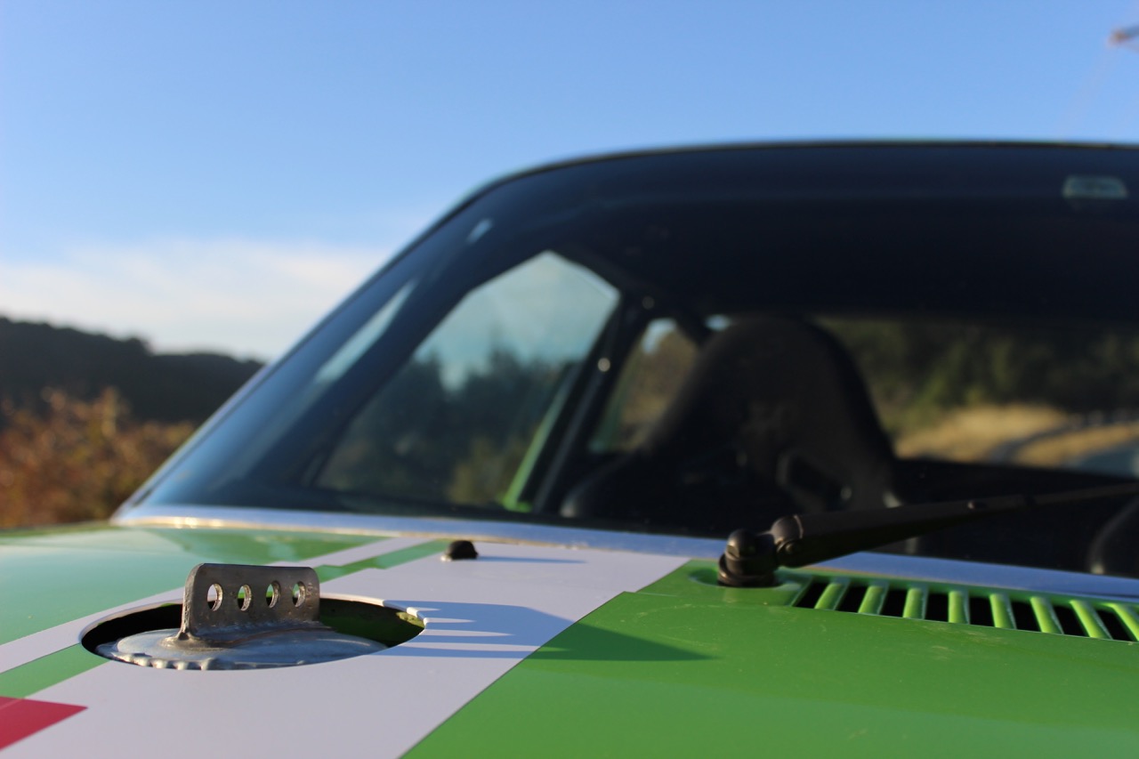

I not only like the look of this mod but adds simplicity to gas fill ups the only negative from my perspective is now gas entry is not protected?
so any one have measurements and close up pics? I am assuming that it is more than just a hole. also probably a ring is welded on hood so as to give a relief even added seal? I think Patrick motorsports has pics in their gallery?

To answer your "gas security" question, it Is possible to mount the Blau cap and filler neck "around" the original, so that the standard 914 neck is still in place - then a locking fuel cap can be used under the Blau cap.
Having done something similar on my car (fiberglass hood), the biggest pain is centering the filler neck to the newly cut hole; even a few mm out looks "off". Maybe someone else on the forum has an optimum alignment method?
