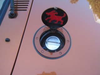

Mounted this using rare earth magnets....

jim_hoyland   Mounted this using rare earth magnets....   Nov 11 2017, 02:54 PM

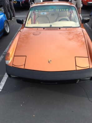

914forme   Saw this at Hersey in 2016, And liked it. Never...   Nov 12 2017, 07:40 PM
somd914   Saw this at Hersey in 2016, And liked it. Neve...   Nov 12 2017, 08:40 PM
