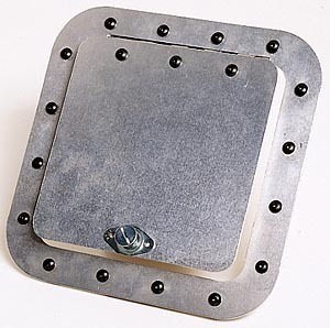

I'm looking at this one from 9xauto.com. (no affiliation) More of an access hatch rather than the actual cap of the tank, but looks like a cool option. I haven't tried it yet, but plan to soon. Attached Image
