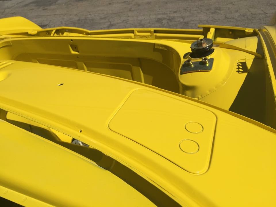

Peter Dawes did the fuel on number 41 a long time ago. The fuel door is from an airplane.

QUOTE(burton73 @ Nov 11 2017, 03:01 PM) *
Bob-your filler is so cool! It's such a novel install using the camloc fasteners.

QUOTE(jd74914 @ Nov 11 2017, 12:56 PM) *
It is not really Camloc fasteners but you push one button down the second button goes up and the door opens. There is an arm inside and pushing the second button down make it pressure lock.
The unlock is engraved open, and the loch is marked close. If I remember it right I have not touched it for 5 years.
It is not just a hinge but has a spring arm and a hinge. The PO had it up and tried to open the front hood and bent it up. E's body man fixed it up. NEW RULE Never open the hood when the gas cover is open.
Bob B

QUOTE(burton73 @ Nov 12 2017, 05:16 PM) *
Bob B
Interesting. I was wondering why there were two buttons. Do you have any photos of the back side? I can envision how it works from your description, but the hardware is interesting-never seen anything quite like that.
