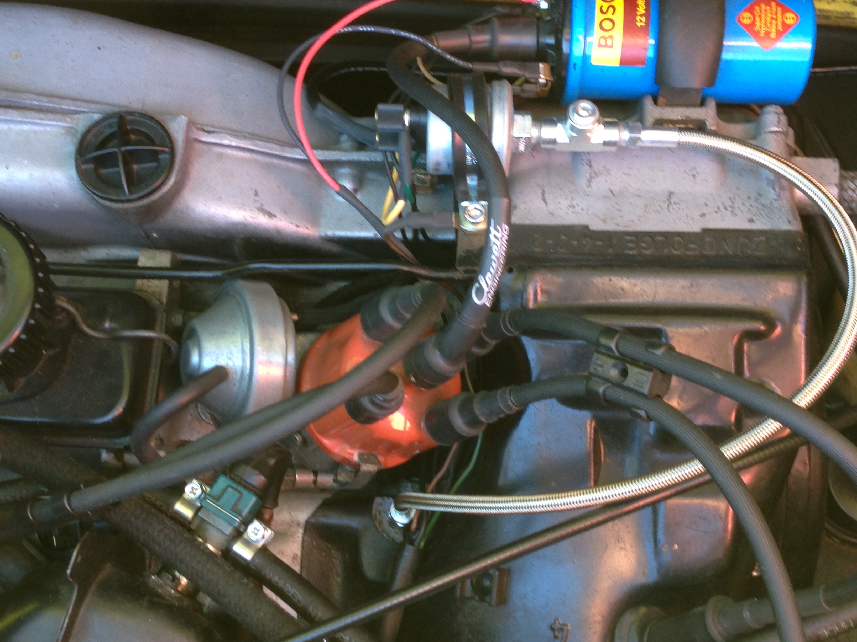

Here is the kit I got from a Miata MX5 performance site. Nice SS hose and fittings.Clamp included.

QUOTE(pete000 @ Nov 13 2017, 11:05 AM) *
Hopefully you have added a ground wire to the outside of the sender. The insulation on the clamp will otherwise interfere with the ground path for the sender, and you're either going to get no readings, or inconsistent ones.
--DD
