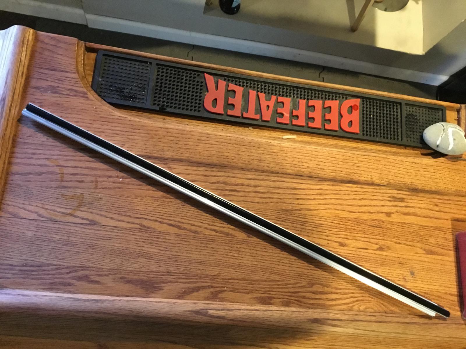

(IMG:http://www.914world.com/bbs2/uploads_offsite/www.thesamba.com-17371-1510759344.1.jpg)
Should the fuzzy window scrapers be cut even with rails.
Same question for the rubber scrapers, too.
Thanks.
