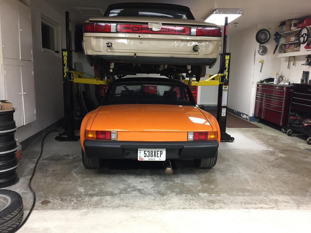

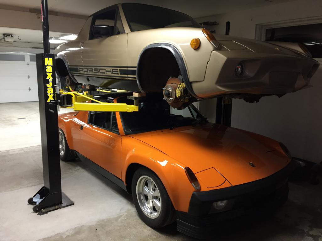

ledfoot
post Nov 21 2017, 08:21 PM
Posts: 54
Joined: 14-February 06
From: Dayton,OH
Member No.: 5,581
QUOTE(mepstein @ Dec 19 2016, 05:26 PM) *
QUOTE(ledfoot @ Dec 19 2016, 08:23 PM) *
QUOTE(Phoenix-MN @ Dec 8 2016, 06:01 PM) *
Does the Maxjax lift the car high enough to park another 914 underneath? I'm sure the car on top would need the wheels removed for more clearance.
No
Guess again...
Just finished my Maxjax install and now have two stacked in the garage. I added the 3" Risers for more clearance. Can't be happier not having to use jack stands. (IMG:style_emoticons/default/aktion035.gif)
