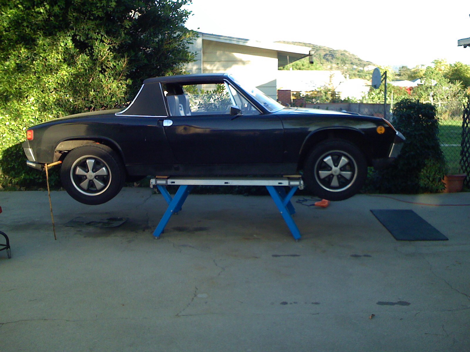

This is what I decided on.
EZ Car Lift, been a great help, added the wheel kit, now this is portable.
No modifications to the garage , uses heavy duty electric drill. Even has a drive over kit for lowered cars.
