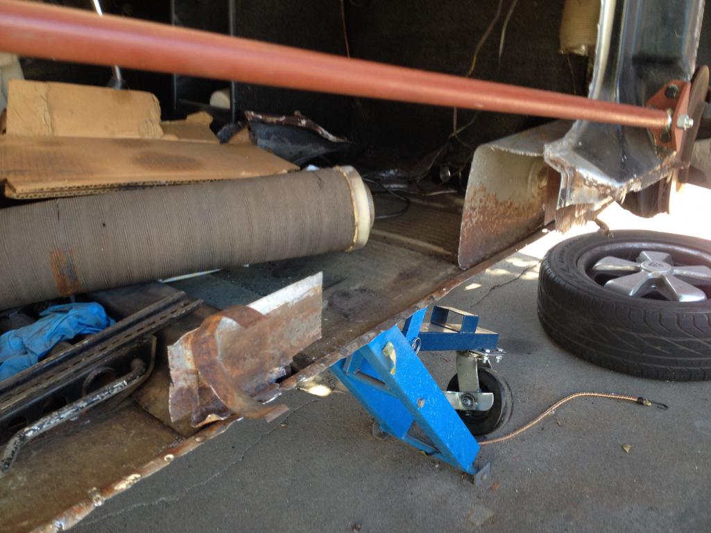

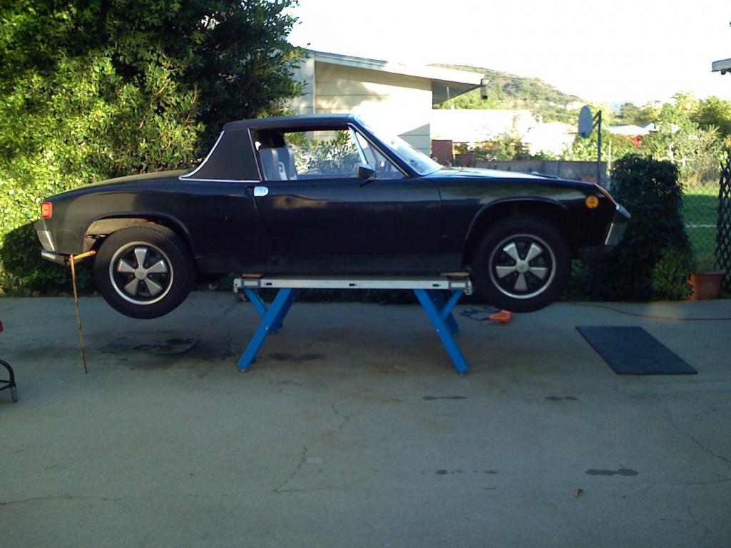

This is what I decided on.
EZ Car Lift, been a great help, added the wheel kit, now this is portable.
No modifications to the garage , uses heavy duty electric drill. Even has a drive over kit for lowered cars.

mgphoto   By using the rubber pads and shorter cross members...   Nov 23 2017, 02:03 PM
