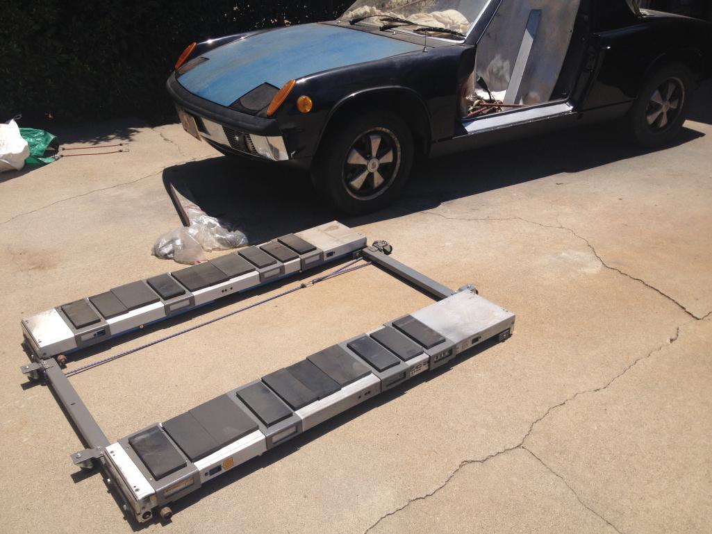

post Nov 23 2017, 02:03 PM
"If there is a mistake it will find me"
Posts: 1,425
Joined: 1-April 09
From: Los Angeles, CA
Member No.: 10,225
By using the rubber pads and shorter cross members I was able to support the pan with great access to make repairs.
Light weight and flexible configurations.

mgphoto   This is what I decided on. EZ Car Lift, been a...   Nov 22 2017, 09:44 AM

mgphoto   By using the rubber pads and shorter cross members...   Nov 23 2017, 02:03 PM
